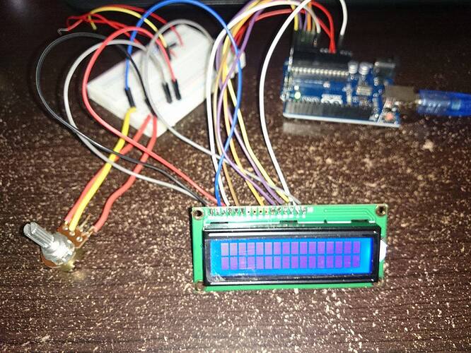

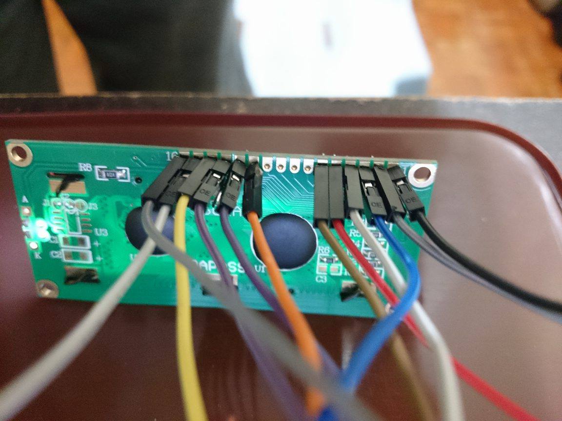

LCD 16 X 2 Only shows white box on line 1 n 2 ( no text shown)
Hai sterretje n all, i just brought a new lcd that is 16 x 2 . I run the code and found that the lcd 16x2 only shown white box in line 1 and line 2 with no text shown... now i really sad, the lcd broken again coz i unable find lcd 20x4 in my hometown only got 16x2 ... IT IS BROKEN AGAIN...?? SAD ... what is the problem occurs again :frowning: :frowning: :frowning:
later i will upload the picture of my connection and the code (previous used for lcd 20 x4), hopefully u all can finds error which i missed... thx u all ..... sincerely thank u ... kindly need ur all help.... thx

Instead of trying a huge complicated program just run the Liquid Crystal HelloWorld program. Does it work ?
The all diagrams
ya, i try it ored... the output still be the same... i never pm someone for help...so u can no worry coz i not the kind that will disturd ppl ... thx
the new Lcd I brought broken again?! OMG....
what is the problem again if u guys look at my connection to arduino.... or my new lcd 16 x2 need other wiring connection with resistor with any pins i miss out.... thx
just post the "Hello World" code which you tried as @UKHeliBob suggested.
And: the wiring ..
Let's get that work first and see if you really bought a broken one, what I don't think.
In 90% of the cases the problem sits about 40cm in front of the PC display :wink:

help me ... why this cant solved problem... i juz brought new lcd 16x2 to replace 20x4 for my project and now broken again.... :frowning: :frowning: :frowning: :frowning: :frowning: :frowning: :frowning: :frowning: :frowning: :frowning: :frowning: :frowning: :frowning: :frowning: :frowning: :frowning: :frowning: :frowning:
what really happen?
KIndly need all ur professional n helping hands..... :frowning: :frowning: :frowning: :frowning: :frowning: :frowning:
My dear, you are repeating what you said already, but don't update with information what you did, what the reaction was etc.
Pls, again:
  1. show us exactly how you connected your LCD with Arduino (handwritten is ok)
  2. show us (in </> code tags) the sketch you have used for the test of the LCD
Without that you can't expect that somebody would invest his/her precious (free) time, ok?
HI rpt007,.... I already post it out... just cover up mu post of other comment
i will repost my code n photo
thx
I am convinced you have a wiring problem. I am running the code posted in #9 and just repeated in the previous post.
If I disconnect the power, open any one of the 4 data lines, and reconnect power I can duplicate your problem shown in LCD 16x2 white box.jpg. If I open RS, RW, or E it only shows one row of very white boxes.
The photographs are not clear enough for me to completely follow, but I think the connections look correct for the pins they are supposed to be going to. If you can post better photographs it would help.
My vote is for a broken wire, poor solder joint, bad bread board connection, etc.
Adjust the contrast pot until the rectangles are barely visible.

Hi cattledog, below i attach more clearly photo to u for check my soldering and the wire ....
thx u so much ....
Do not use the same coloured wires for GND and +5v.
Crank the contrast pot down so the white rectangles just dissapear !
Edit
Wire the back light as in the tutorial I posted.
