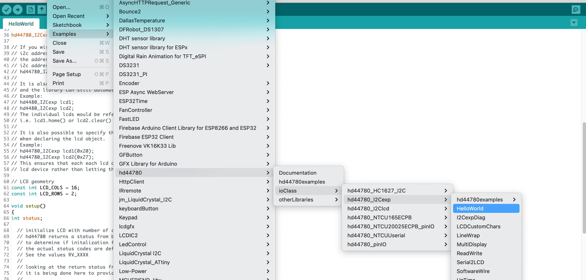

Ok... let's start slow. Firstly you need to install this library. In the IDE, under Tools > Manage Libraries, search for and install this:
Once you have done that you will have access to the examples that come with it...
I suggest starting with this one...
See if you can get that working first. If you can then you can move onto making changes to your code to use this new library.
If, after installing the hd44780 library and uploading the "Hello World" example you do not get a satisfactory display, you can upload and run the diagnostic program. The output, in serial monitor, from that program can be a great aid in helping to get your display to work. Copy and paste the serial monitor output to a post so that we can see it. Also the author of the library is often around and can be of great help.
Path to the diagnostic code:
Got that working great. Thanks.

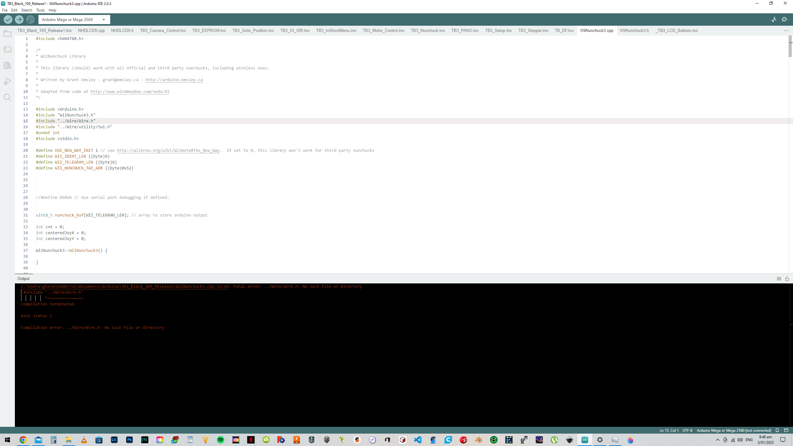

Ok I think I got it right but get an error
\TB3_Black_109_Release1 (1) (1)\TB3_Black_109_Release1\WiiNunchuck3.cpp:13:10: fatal error: ../Wire/Wire.h: No such file or directory
#include "../Wire/Wire.h"
compilation terminated.
exit status 1
Compilation error: ../Wire/Wire.h: No such file or directory
Remove that line... the first one below.
#include <hd44780.h>                       // main hd44780 header
#include <hd44780ioClass/hd44780_I2Cexp.h> // i2c expander i/o class header
Looks like that library is already included in your sketch (line 77).
Thats not working If I remove ../Wire/Wire.h . I am not seeing what you are referring to.

You have it included twice...
Ok got that one . Still getting this error
WiiNunchuck3.cpp line 13
Do you have this library? Where did you get in from - I was not able to find?
Errors like that are typically from really old code that will no longer build with more recent Arduino IDEs and tools.
The older IDEs did not support automatically locating dependent libraries within library code.
i.e. if a library depended on another library the IDE would not locate the directory where the library lives and add it to the include path. This meant that doing something like
would not work for library code.
To work around this issue, library code would do something like
This worked since in the old days user libraries were installed next to the bundled libraries like Wire so the relative path for the include would find it.
Those days are LONG over and since bundled libraries are no longer near user libraries an include like that will fail.
I'm guessing that this is the issue.
If so, the code with the issue of using the relative path for the include should be modified to include Wire.h from the include path, i.e.
That said, if the code is old enough to be using that older type relative path include, it may also have other issues.
--- bill
