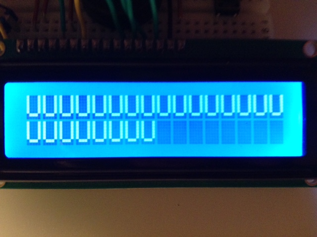

Im making a project where I collect data and print it both on the lcd and SD card. Im using a sparkfun SD module and the standard LCD 16x2 screen that comes along with the starter kit
When I power the Arduino UNO with the following code the "welcome" message shows on screen but not the rest of the information that are also supposed to be printed in the void loop() function!!

... also the lcd with same setup without the .csv file writing works just fine but when adding the code needed to write to the datalog.csv file on the SD card the lcd prints nothing during the void loop() function

I know that but thats not the case. Im using a sparkfun SD card module which uses all arduino UNO pins as its on top of it. the lcd then uses pins 12,11,5,4,3,2 that are on top of the module.
When using another code again using the same setup(lcd + SD module) it works perfecly fine but when I upload this code it doesnt print the information I need (steps , duration , duration2) , but instead the screen remains in its default state.
Also the lcd works fine on its own ...
but I thing the problem has to do with the code or something because I think it doesnt execute the
if(steps > 20){
part, but Im not sure and I dont know how to fix the problem

for some reason the lcd doesnt print the information but in this code it does....

FWIW: the code you have just posted (which works?) has this statement:
  lastButtonState = buttonState;
outside the first if statement, whereas your original code (which didn't work?) has it inside the if statement.
Pete
I tried what el_supremo said and the lcd worked but..... another problem apppeared the lcd instead of printing what I needed it to print it prints that.....
