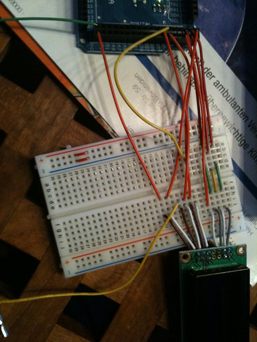

Yes, it doesn't work after following this steps. I'll post the wiring: here it is: djnitro | Flickr

OK - The third photo shows that the contrast is acceptable. You may want to tinker with it after you get the rest working.
Now you have to get your connections cleaned up and organized.
(1) Remove all the wires (ouch).
(2) Arrange the 14 connections between your LCD module and the breadboard so that they are in a single row on the breadboard, just as if you had plugged in one of the modules that has all 14 pins in a single row.
(3) Reconnect the power and the contrast potentiometer and make sure you see the blocks again.
(4) Connect R/W to ground (you did do that before, didn't you?).
(5) Connect the other six lines, using different colored wires if possible.
(6) Enjoy your Hello World display.
Don
Thanks, it's working now.
I just added all the wires and now everything's fine!
