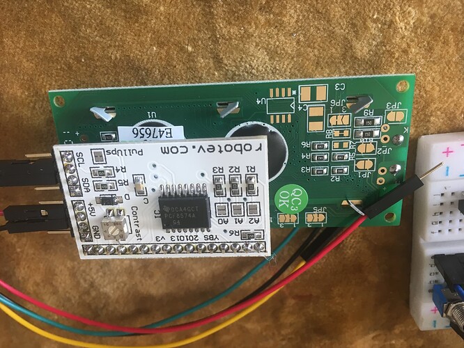

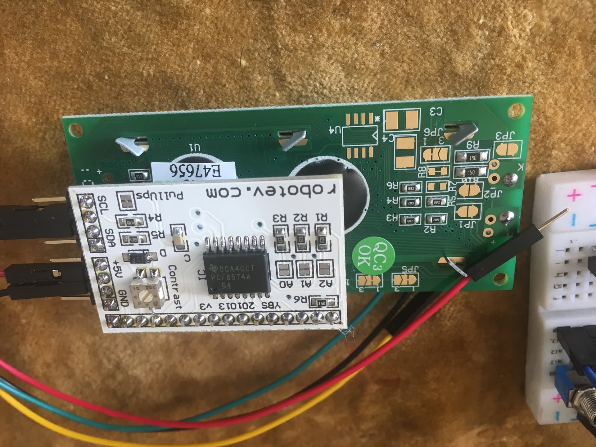

Hello i am trying to build the following model:
I have differences with the parts i got. The ping sensor in the project is with 3 pins and the one i have is with 4 ( Echo and triger signals)
What should i change in the code to make it work ?
Also i have difference LCD display than the one showed in the project. It have SCA/ SDL outputs. If i connect them with the corresponding pins on the arduino board SCA/SDL will it work with the same code or i need to change it and if yes could you advice me what to read to do so ?

My advice:
  • Install the NewPing library and use the examples there to see how to use the 4 wire sensor.
  • Install the hd44780 LCD library and use the appropiate example to see how to set up the I2C LCD. Once it's set up and initialised, you will keep your existing lines like lcd.write() and so on.
const int TrigPin = 2;
const int EchoPin = 4;
long duration = 0;
uint8_t cm = 0;
  pinMode(TrigPin, OUTPUT);
  pinMode(EchoPin, INPUT);
  digitalWrite(TrigPin, LOW);
  delayMicroseconds(2);
  digitalWrite(TrigPin, HIGH);
  delayMicroseconds(5);
  duration = pulseIn(EchoPin, HIGH);
  cm = duration / 59 ;
  Serial.print(duration);
  Serial.print(" duration\t");
  Serial.print(cm);
  Serial.println(" cm");
Maybe these will help with the display.
