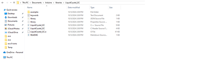

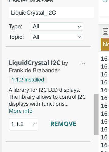

This seems to be a common error due to library issues and unfortunately the link to the library that was used for this guide is broken. I've gone through a bunch of different fixes in an attempt to get this working and I think at this point I've overwhelmed myself with information.

This is the code being used, I've downloaded probably 40 different libraries and I'm sure this is just an issue with the way I'm doing something but maybe someone else can walk me through this. I did run a couple of the library examples such as the hello world and those work fine. My address for the LCD is correct at 0x27, what am I missing aside from obviously this code isn't compiling and the LCD.h properly. Thanks for the help!
