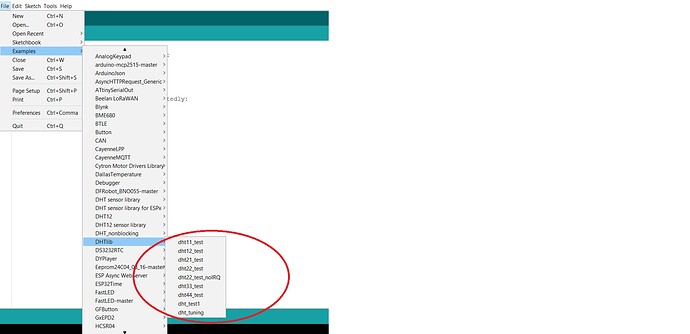

your code could get stucked in your function start_test();
Add debug messages so you can follow what your sketch is doing.
lot of serial println debug messages will help you to understand what your code is really doing.
Why aren't you using a DHT11 library, there should be at least one in the IDE library list?
