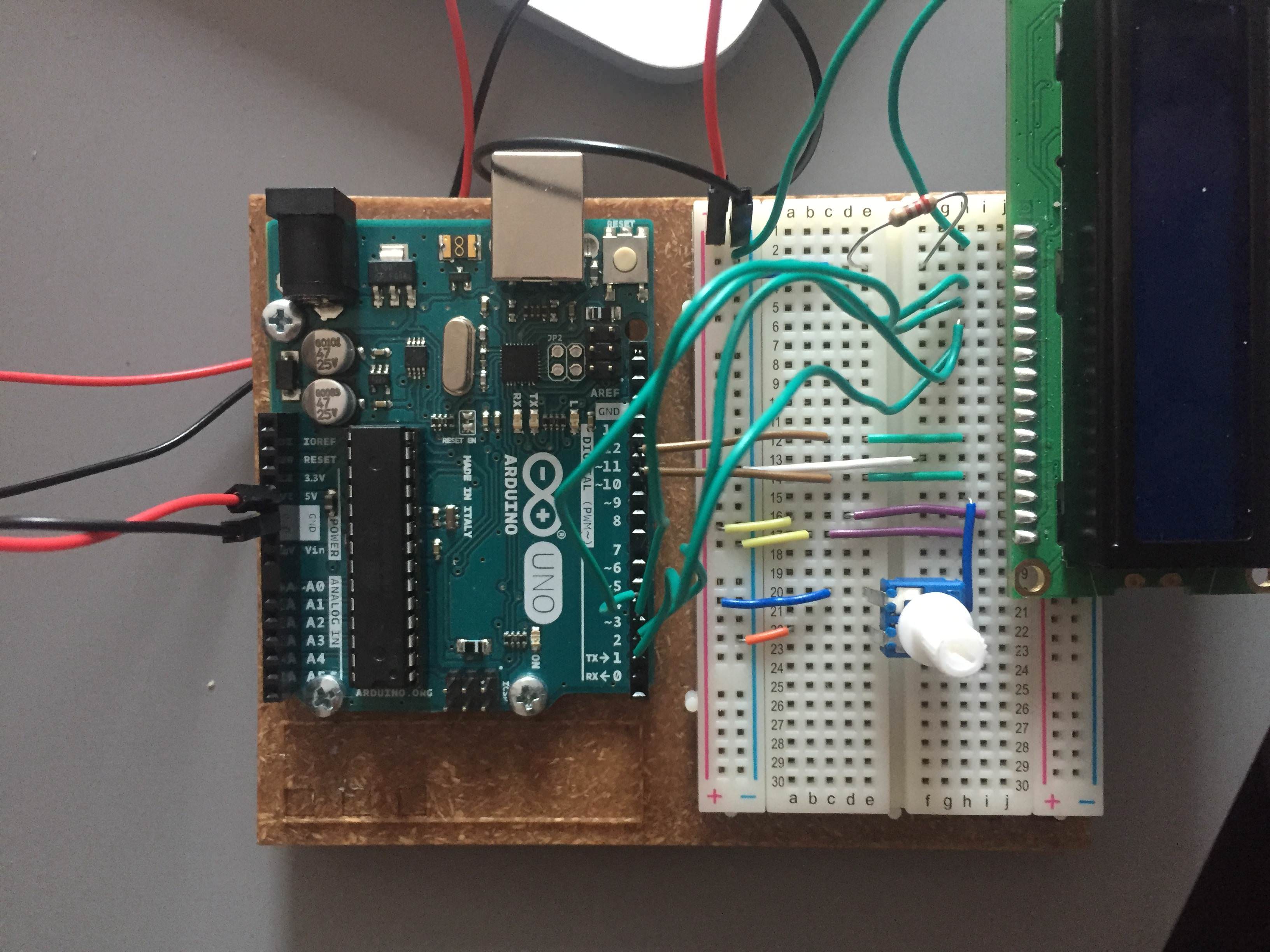

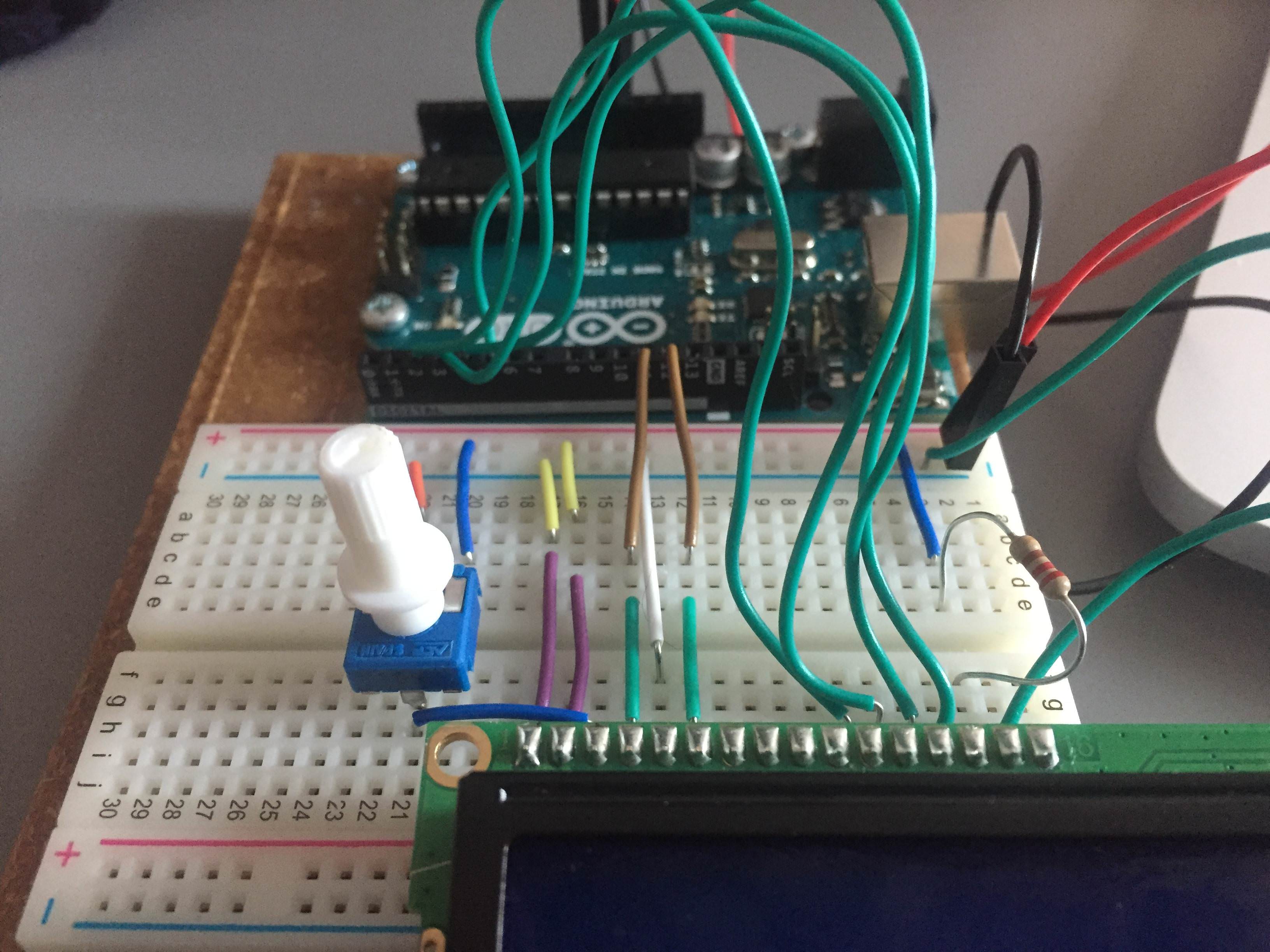

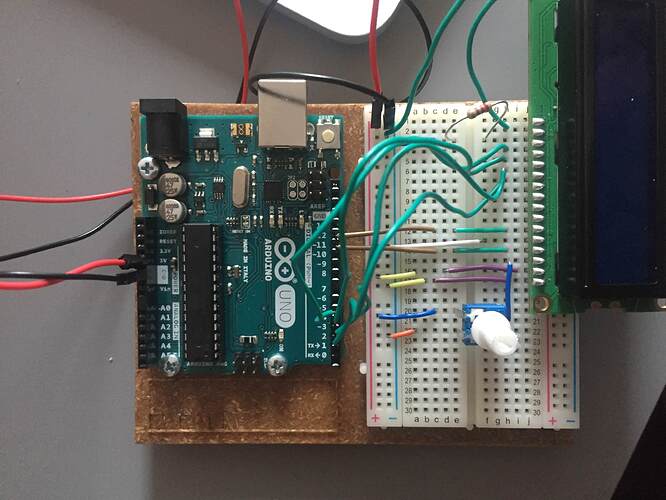

First problem: I can't print anything to my LCD
Second Problem: If I plug in R/W (PIN 5) to ground as all tutorials are telling me to, the arduino and lcd both fade and turn off within 2 seconds of connection to power. If I disconnect pin 5 the LCD turns on and the board stays on and both are lit up indefinitely (except no text can be written). Pictures below followed by code.

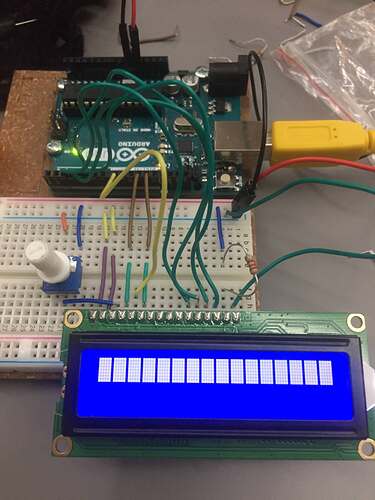

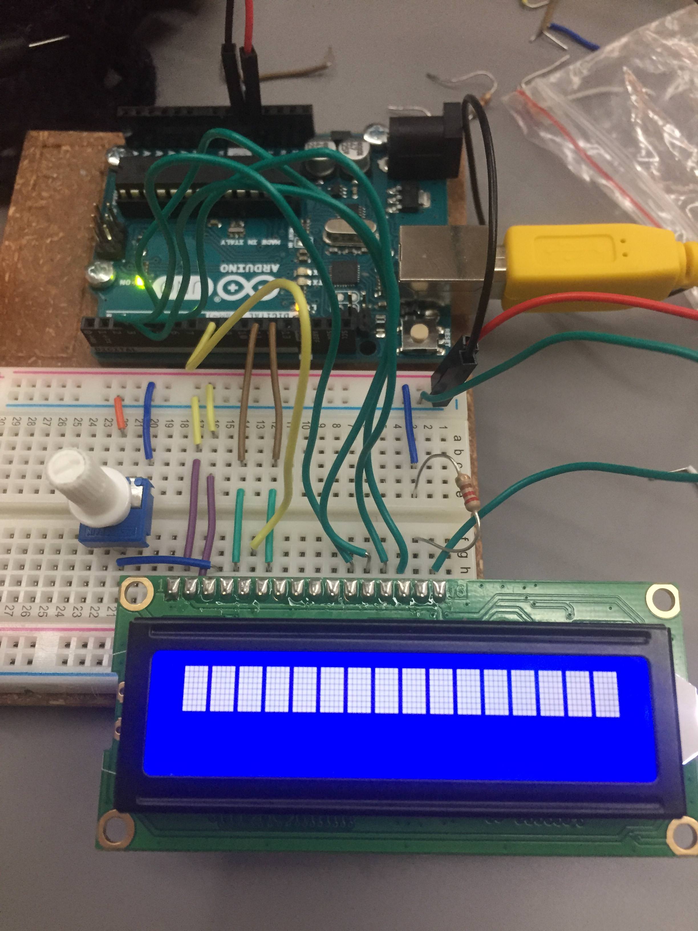

I left D8 plugged into LCD 5 and uploaded your sketch.
It does not appear. I just have white boxes in the top row (contrast at max) or nothing if I turn down contrast. Here is the image: https://imgur.com/a/lu9lF

This is a normal picture of a healthy LCD?

How about a bad breadboard?
Don
Yes! The breadboard should be suspected. In the next step of trouble shooting, direct jumping is to be made between the LCD pins and the UNO pins.
