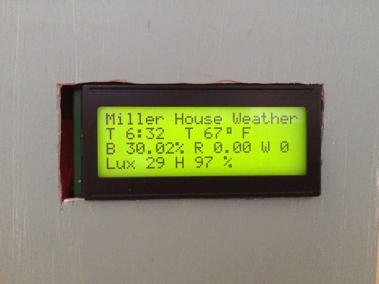

I made a weather station using my own sensors.
I have temp, humidity, barometric pressure and lux at the moment.
I need to fix my rain & wind sensor setup.
Get some ideas from my setup.
