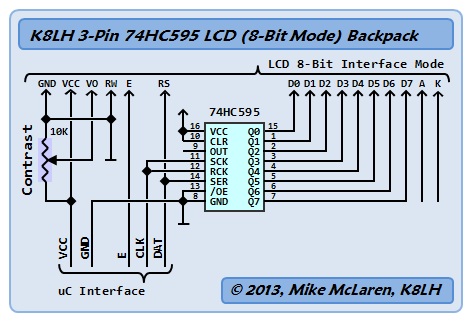

dhenry:
Connection:
MOSI pin: from the mcu to shift register's data pin (pin1+2 on HC164 and pin 14 on HC595). LCD's RS pin tied to this line as well.
SCK pin: from the mcu to shift register's serial clock pin (pin 8 on HC164 and pin 11 on HC595)
Enable pin: from the mcu to the lcd.
What about the RCK line (pin 12) on the HC595? Anything connected to that? A schematic for your 3wire HC595 interface would be welcome.
Advantages over other 3-wire solutions:
  1. It allows 8-bit as well as 4-bit mode.

Are there any example 3-wire interfaces that drive an LCD in 8-bit interface mode, please? I designed one that uses 3 pins on a 74HC164 but I was wondering if there were any others?
TIA, Mike
Connect it to the Enable line: those people who designed HD44780 are incredibly smart and with tons of foresight, :slight_smile:
dhenry:
Ahhh! Oooo! Nice! Haven't seen that one anywhere before... So something like the second drawing below. That's much better than what I came up with a couple days ago which requires an extra clock pulse.
Thank you Sir. Cheerful regards, Mike
Yes.
In the code I wrote earlier, I forced a particular connection (Q0 -> D0, Q1 -> D1, etc.) With a little modification, you can remap those pin connections to your own liking, providing additional flexibility for your layout guy.

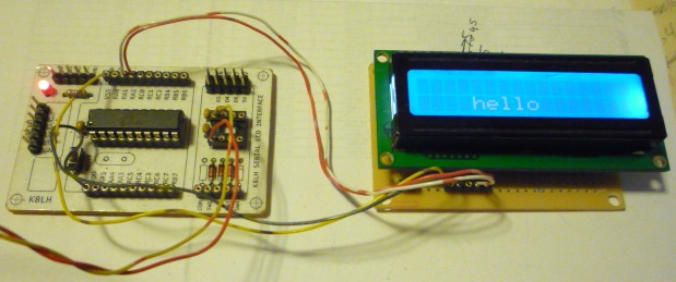

Hey, I added an RC integrator and tested a 2-pin 8-bit design but I'm a PIC guy (sorry). Anyway, if you're interested, I've attached a shot of the board just moments after it came up (first try!) and another couple shots of the board before I added the RC parts. The host is a PIC18F14K22 (16 MHz) with an assembly language program. The low level LCD driver uses 28 words of program memory and is isochronous. With delays for the RC tau of 3.3 microseconds, it takes precisely 83.75 microseconds to send each byte to the LCD.
