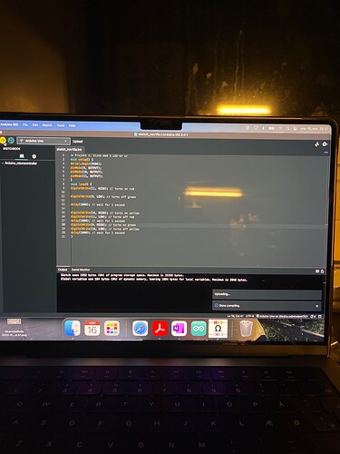

Can you show us a full screen shot just before you do an upload?
I can't see if you have a port selected.

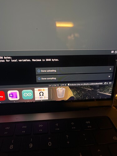

It says, "done compiling". Then "uploading"... my guess is that there is a problem with the connection or options, the new IDE lacks explicit error reporting for whatever is causing the issue.

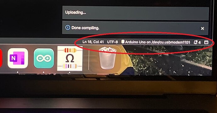

What operating system are you using?

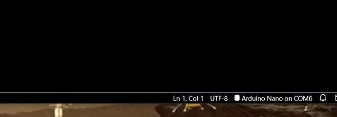

If it is windows, the circled area should say what com port number you are connected to?
My 2.0.1 IDE with Nano connected. OS WIN 10.
