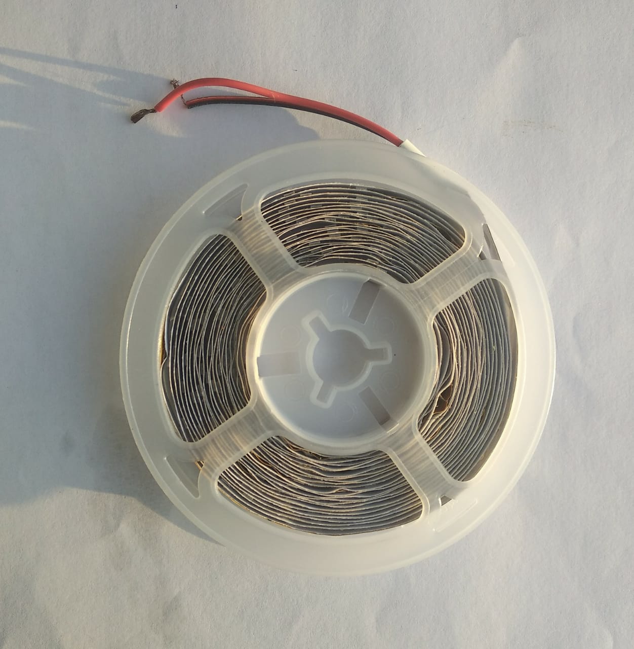

This is the specs of the LED strip.
Ir InfraRed 850nm 940nm Fita led strip light DC 12V SMD3528 60leds/m.

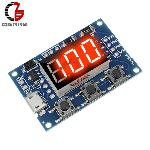

Next question: do you really need an Arduino for this? Perhaps you could use one of these signal generators instead.
Serial interface and all? PWM? Makes you wonder what's in it. :astonished:
Remarkably cheap!
Just ordered one to check it out. Give it a month. :grinning:
The thing that worries me about the OP's LED strip is the description that says:-
Ir InfraRed 850nm 940nm Fita led strip light DC 12V SMD3528 60leds/m IR LED Tape
Now IR LEDs are either 850nm or 940nm not both at the same time. It could mean that the strip alternates between a 850nm LED and a 940nm LED. But what I guess is that the seller hasn't got a clue about what he is selling.
As this is for research then you must check exactly what you have.
Grumpy Mike, Just received the package yesterday. It says LED color 940nm. So no confusion there.
