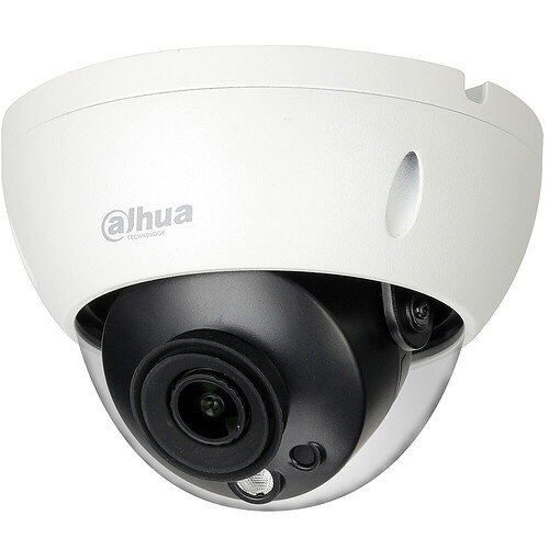

can I use this camera?

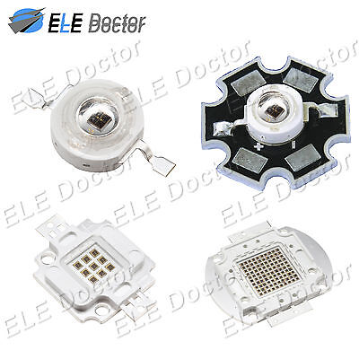

i dont think the quality of the footage is important, more important with energy efficiency and ability to capture at daytime, light, and at night time, dark. I found these ir lights on ebay. the smallest one takes 1w, it is probably enough. Can I reduse the powerconsuption by increasing the size of the resistor? If it is too bright?

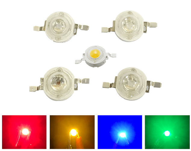

Just generally speaking, without knowing you project/specs etc.: I was once gifted one of these 1W LEDs AMAZON LINK from a shop I bought some components from and was really impressed by the brightness of it.
Ok, here is one with 0.5w. the room is actually smaller than 5 by 5meters, probably more like 4 by 4 meters. Maybe I can make it dim automatically up and down and each time it is down i use a quality photoresistor to check if the light, sun, is back up? Would dimming it reduse the energycost similary to increasing the resistor would reduse the current and efficincy?
That camera has a builtin IR-LED. It will need more than
AA-cells. Lots of data to handle (a job for a PC)

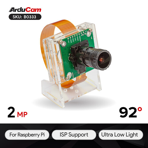

Ok, what about this camera? This one seems to be working both day and nigh and probably work with both ir led or normal led if it is completly dark.
What resolution do you need?
Does it matter how much of the room the camera can "see"
