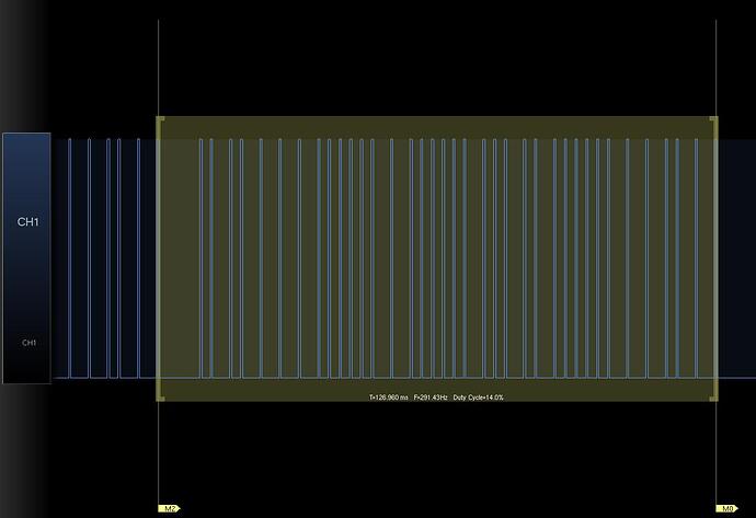

Most weather station sensors use a 433Mhz wireless module that sends data using OOK so finding some examples of how they define 0 & 1 bits may be helpful and then substitute a LED for the RF module. I have attached the output of one such sensor. The long off hook is to signal the start of the message and then short off hooks are one's and longer are zero's. The signal is pulsed high for a short period between bits.

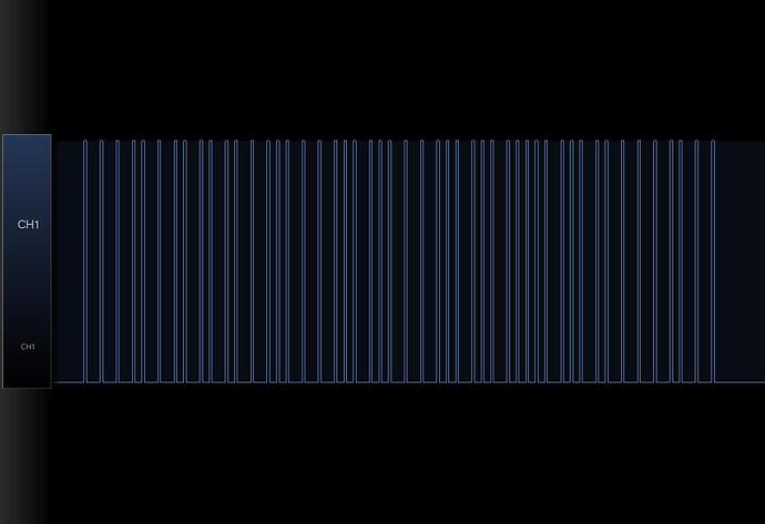

Untested code but the basic idea would be something like this...
const char message[] = {"Hello!"};
const byte outPin = 13;
const int beginDelay = 100;
const int zeroDelay = 50;
const int oneDelay = 25;
const int bitDelay = 10;
  pinMode(outPin,OUTPUT);
  digitalWrite(outPin,LOW);
  delay(beginDelay);
  Serial.println("Delay");
  for(int x = 0; x < sizeof(message) - 1; x++) {
    char a = message[x];
    Serial.print(x);
    Serial.print(" ");
    Serial.println(a);
    for (int y = 0; y < 8; y++){
      byte z = (a >> y) & 1;
      Serial.print(z);
      digitalWrite(outPin,HIGH);
      delay(bitDelay);
      if (z == 0){
        delay(zeroDelay);
      else {
        delay(oneDelay);
    Serial.println();
  delay(bitDelay);
  Serial.println("Finished.");
  while(1){
EDIT: Added LA sample from above code.
