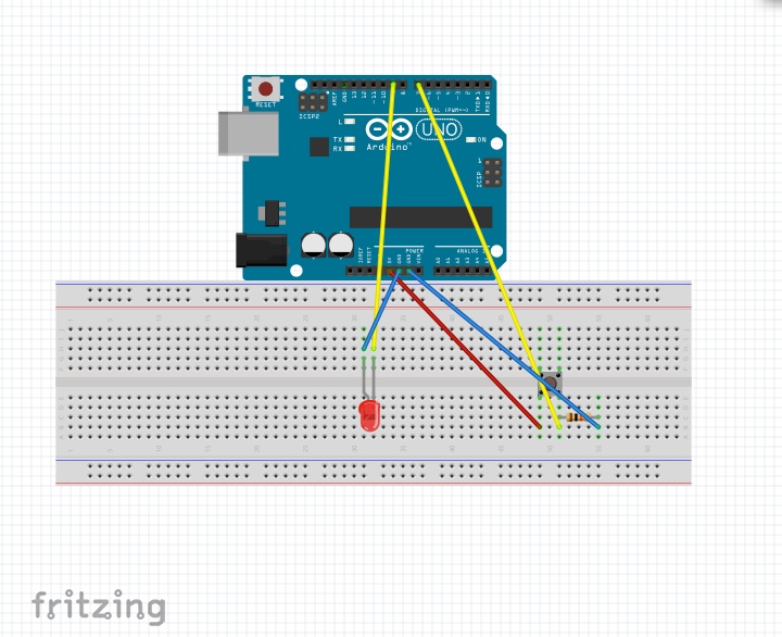

I've wired the circuit as shown below in the fritzing image, and used the code posted below. It is straight from the book, word for word, but I'm having weird results. Whenever I upload the code the LED begins blinking, fading from full brightness to off, then back to full. Regardless of me pressing the button or not, as if the button made no difference or wasn't even involved in the whole thing. I'm unsure at this point if my problem is in the wiring or the code (my guess would be code....?). Any ideas? I've tried looking up problems with the example or instructions and can't seem to find anything so it must be something I'm missing... I've triple checked my code and it is same as the book.

You have no resistor in line with that LED so you will damage your arduino pin.
The switch looks like it is wired up correctly so check that the wiring actually matches this and you have solid connections.
Thanks for the feedback Grumpy_Mike. I actually ended up removing the resistor since the LED wouldn't turn on with any kind of resistor. Book suggested a 270ohm but whenever it was there LED would't work. I tried with down to a 50ohm actually have that wired in there. I've checked the wiring and it matches! So good to hear at least that looks good... Here's the updated image of the wiring.

If the LED will not turn on with a 270R resistor then it sounds like your solderless bread board is shot or not making proper connection. Rebuild the circuit with the resistor using different holes, that is move it along the breadboard five holes or so. Then you do not use the same tracks.
Sounds like you have the same problem with your switch.
This is why I hate solderless bread board, it gives you extra troubles.

Well I tried a smaller resistor value on the same holes on the breadboard and the LED worked fine. The pushbutton I moved to a different place and seems to have not changed anything.
I left the wiring the same and setup the pushbutton LED example (on and off when button is held) and it worked just fine so it seems the button and LED, alongside with their respective position on the breadboard work fine....
Whenever I upload the code on the above sketch though the LED just fades in an out still, regardless of the button presses (supposed to turn it on and off at a quick press and change brightness when held)

So did you put the original 220R back? Was the lead of this resistor tarnished in some way?
Basically thousands of people have done this tutorial, and the fact that you can not get it to work means that you are doing something wrong. What we have to do is to find out what. You are offering no more information than the simple, "yes I did that but it still didn't work".
How about posting a photograph ( not more than 1000 pixels ) of your set up so we can see if we can spot your error.
Sounds good, I got it to work with a 50ohm resistor but even the 220ohm wouldn't do it making it past a very faint glow. (tried different LEDs). Here'a link to the setup image I was able to take with my phone. Hope it helps see what's going on.
Image link Imgur: The magic of the Internet
Swapped out the 50ohm for a 150 and all looks good. (brightness-wise) button still useless :frowning:
FINALLY. I rewrote my code and rebuilt the circuit the exact same way with a 150ohm resistor and it worked flawlessly. No idea yet as to what the error was... (code maybe? Still copied off same part of book...)
My guess was that it is this.
I came across this a short time ago, read the second answer.
Sometimes those bread boards have a break in the middle of the power supply traces. I notice you have got some home made colored lines. Have you checked the continuity from one end to the next. That might explain your symptoms of the LED working but the switch not.
