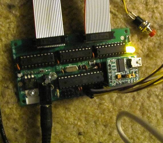

I have a small board with arduino functionality and 3 shift registers that can drive 8 RGB strips.
Or 24 monocolor LED strips.
