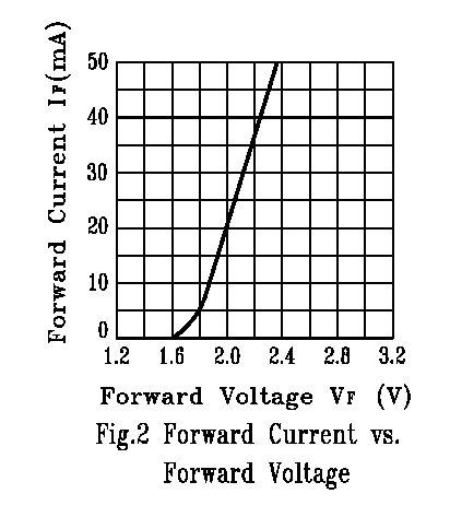

In my opinion, if you have four 3V LEDs in series across a 12V supply, you only need a minimal resistor. This ruins that equation about LED resistors because the impedance of an LED varies over the V-I (voltage - current) curve.
http://www.cq.cx/pics/int-led-vi.png
This shows the impedance at 1.8V forward voltage to be 360 ohms and 100 ohms at 2.0V. This is a wide variation, and although LEDs have resistance, it is not fixed like a resistor. Since none of the electrical characteristics for an LED are fixed (voltage, current, resistance), simple Ohm's law equations like the one you showed break down.
I would put the 4 LEDs in series and test the current with a DMM and see what resistance you need. You will not blow up the LEDs this way, though the live may be diminished if the current is too high. I don't see a problem arising, though.

Scot, I don't think you have quite grasped the concept of resistors and non liner devices. Operating an LED on the knee of it's characteristics and using that as your current limit is at best hairy and will produce a non repeatable design.
Not having a resistor is only dangerous if the supply voltage might change.
Simply NO, there are other things that change. The knee characteristic of a LED varies from device to device, manufacturer to manufacturer, LED technology to LED technology and it varies with temperature.
So you will end up with a circuit that will only work with the components you played about with at the temperature you played with them. So it could work fine at 20C but then it gets hot and you are operating at 35C and bang you burn out your LED. Look up thermal runaway.
Again, I agree, a small resistor won't hurt.
The smaller the resistor is the less effective it will be in curbing the variations in the LED characteristics. The smaller the resistor the less useful it is in regulating the current. When the forward voltage drop of the LEDs approaches that of the power supply then it is time to think of other current limiting measures like a constant current drive. It is not a time for thinking of abandoning all forms of current control. This is why high power LEDs are not usefully controlled with a series resistor.
Sorry to stamp on you so hard but it is important that beginners don't go on to think that current limiting components on LED systems are something of an option. It is also important that you don't think that as well.
