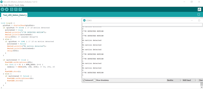

The code above, what happens is, when motion is detected, it sends it into a loop, it says "MOTION DETECTED" 2 times, turns on the lights, then say "NO MOTION DETECTED" 2 times, and turns them off, this continues on and on
Sometimes, it works fine, but it's like, if I stand still, it will work and turn off, but then when I move it just starts flashing. I think it's because of the delay in the sensor, I'm not too sure. How can I get it so that if a person moves their arm once, it turns on until that person has removed their arm and it stops detecting motion.

Here is the code:

So, my main goal is as follows:
The Motion Sensor (specific model: HC-SR501) is set to a distance of about 3 metres and a delay of 3 seconds. My goal is to turn on the LED strip, when the value is read as true, this value is set to true when the motion detector detects "HIGH", the value is set to false when the motion sensor is set to "LOW". These values are then handled separately, below in the code, it checks if the value is True, then it sets the lights on, and if it is false, it turns the lights on.
My current issue right now is the lights blink, they come on for about 1 second, then turn off for one second again. I don't know if the motion sensor is reading something wrong but where I get it to print, it says "MOTION DETECTED" followed by the value true, it prints this 2 times then says "NO MOTION DETECTED" followed by the value false, this loop continues leading the lights to blink on and off.
The flashing is the lights going on and off, the goal is to just have it so that if I hover my hand over the sensor, the lights turn on until the sensor outputs as LOW (no motion detected) then the lights turn off.

bool activated = "";
Have you tested the LED logic separately from the PIR by just toggling the input pin with a jumper?

I think, FastLED.setBrightness() only sets a scaling factor for set functions like fill_solid(). If you populate the buffer directly as you did, it won't have any effect. It doesn't control the strip brightness directly, either. AFAIK, I could be wrong.
Anyway, you should remove the PIR from the equation for testing.
Also, how are you powering the strip? Have you run some simple LED test sketches to ensure that the strip is adequately powered and fully working?
