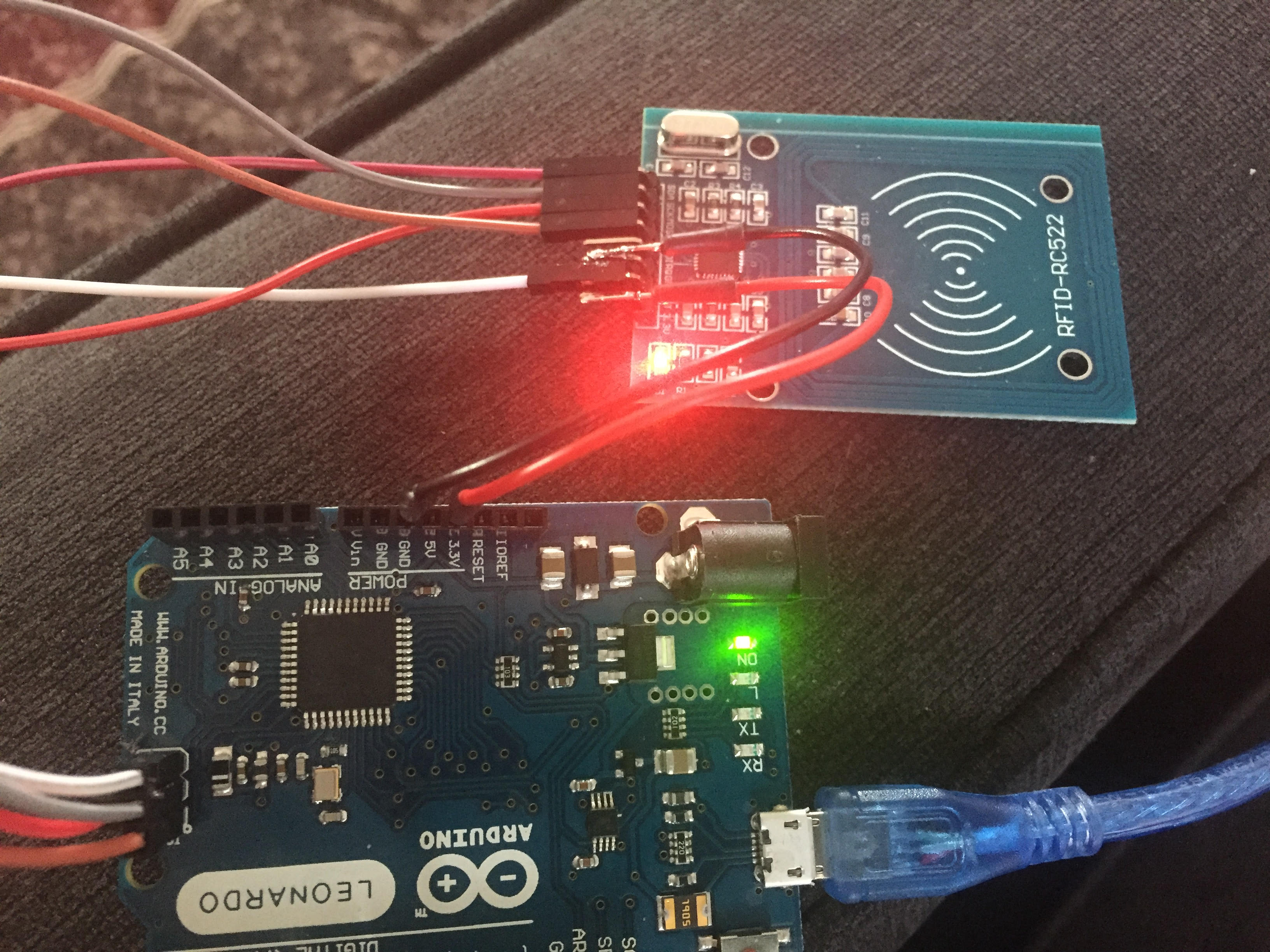

I am using Arduino Leonardo with RFID reader and writer RC522. I used this library
I can compile the code and can upload for the
rfid/DumpInfo.ino at master · miguelbalboa/rfid · GitHub Example.
When I open the Serial Monitor I see this
Firmware Version: 0x92 = v2.0
Scan PICC to see UID, SAK, type, and data blocks...
But when I put the rfid card that came with the rc522 board, it does not scan it. I have spent over 20 hours looking into it and cant seem to find propblem. Can anyone help
When I put the debugger above return statements,
mfrc522.PICC_DumpToSerial(&(mfrc522.uid));
// Look for new cards
if ( ! mfrc522.PICC_IsNewCardPresent()) {
return;
// Select one of the cards
if ( ! mfrc522.PICC_ReadCardSerial()) {
return;
// Dump debug info about the card; PICC_HaltA() is automatically called
I get this error
Card UID:
Card SAK: 00
PICC type: MIFARE Ultralight or Ultralight C
Page 0 1 2 3
MIFARE_Read() failed: Timeout in communication.

Thanks for the reply. However even if I get rid of the !s and returns, essentially it will do same if I put this at the top of the loop statement
Which I did and then I posted the error that I got. Now since I am very new (2nd day ) with arduino, I am not sure how to handle this. Looking for some help here
