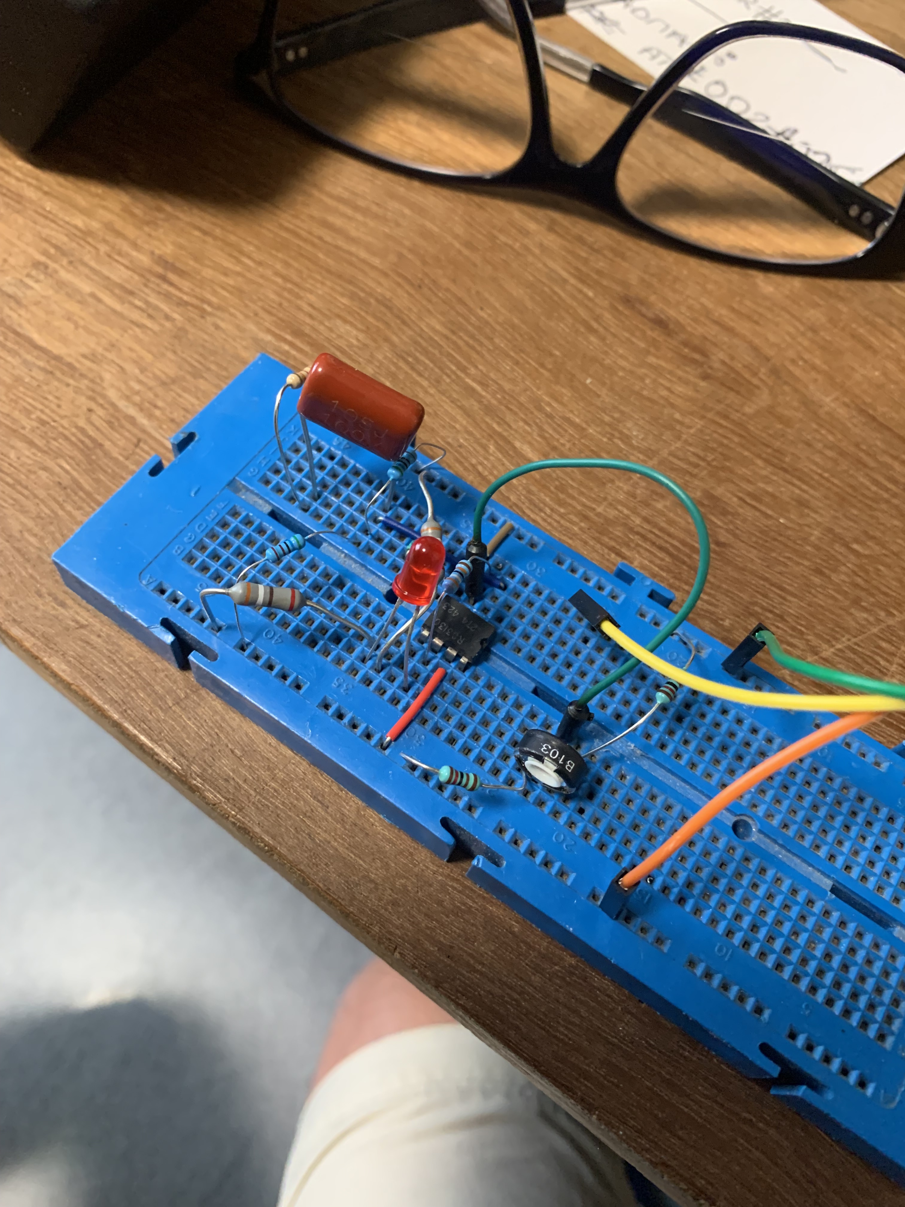

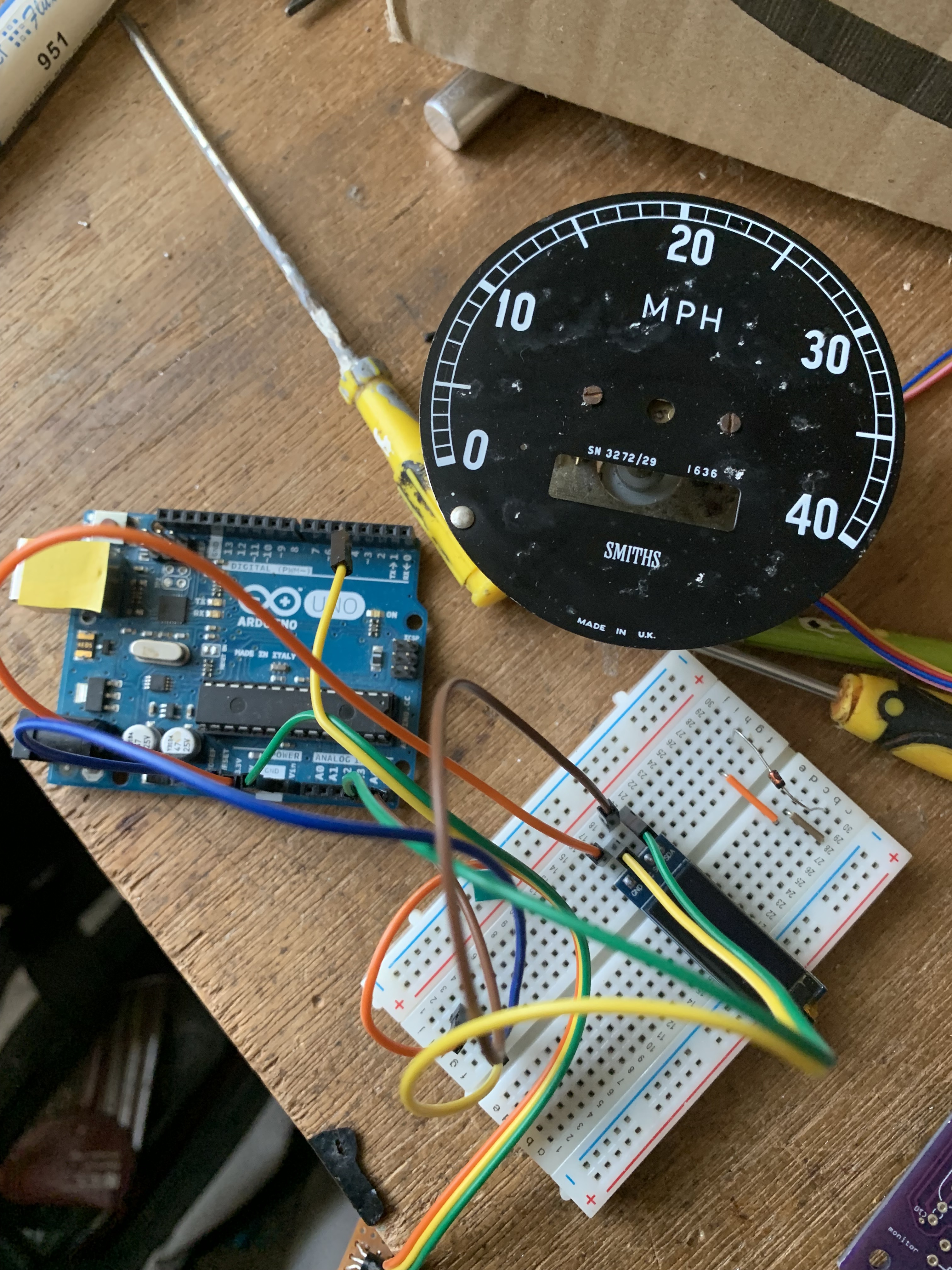

Another example here - making an analog speedo with inductive sensor input - to design the signal conditioning - breadboard that part , then the display part , then go to PCB !
It’s not just for hardware , you can checkout if your coding is likely to work
  • Blue breadboard, you have exposed your age :shushing_face:
  • I’ve started using this old man wiring error protection idea. :older_man: :woozy_face:

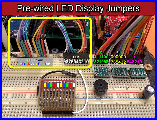

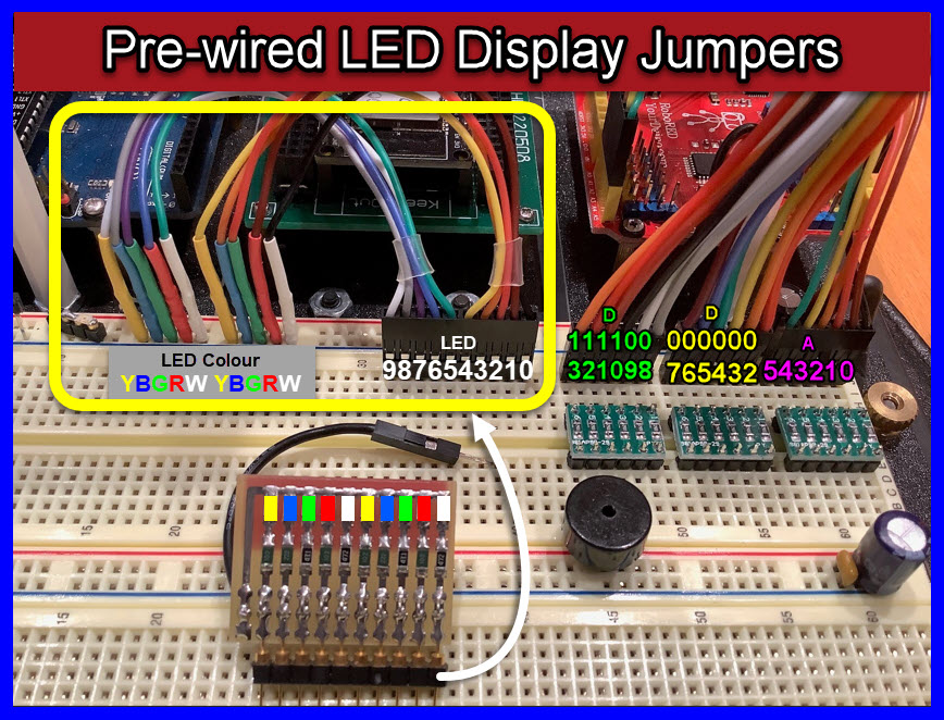

I use a prewired header for the LED display PCB:
OP, You may find this useful:

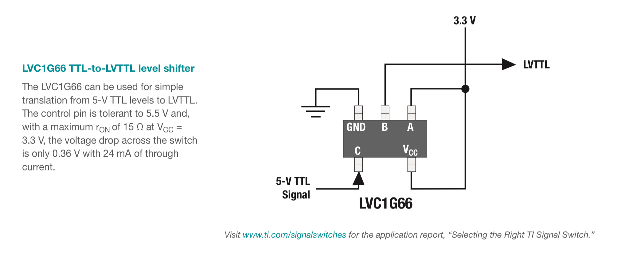

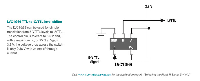

It appears that for level shifting in particular, the LV1T parts would be best.
https://www.ti.com/lit/ds/symlink/sn74lv1t34.pdf
Yep … still the best board I have too🤣
I have used plastic chopping boards or pieces of ply to mount Arduinos, switches bread boards etc to stop it all falling apart .

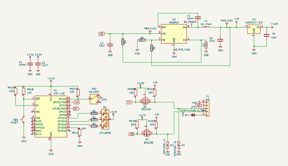

New PCB arrived, built and tested. Everything works as expected now.
For the benefit of anyone reading this post later, below is the complete schematic:
It's nice when things work.
What is the power input voltage ("DC")?
14-20 V
Also made some other changes compared to the original design, for example the RGB Led that emits different colors to indicate different conditions, ie WiFi Connected, A/C online, MQTT server error etc..
