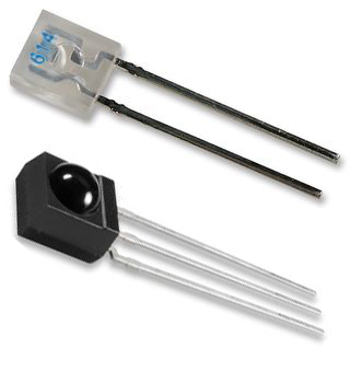

this my emitter and receiver :
![](http://i.ebayimg.com/t/IR-emitter-receiver-Universal-Remote-36KHZ-Arduino-/00/s/MzQwWDMyMA==/$(KGrHqJ,!joE9UbgeycIBPntV1BPsw~~60_1.JPG)
datasheet : http://www.arduinodiy.co.uk/ebayimages/ebaycontent/IrReceiver30492.pdf
