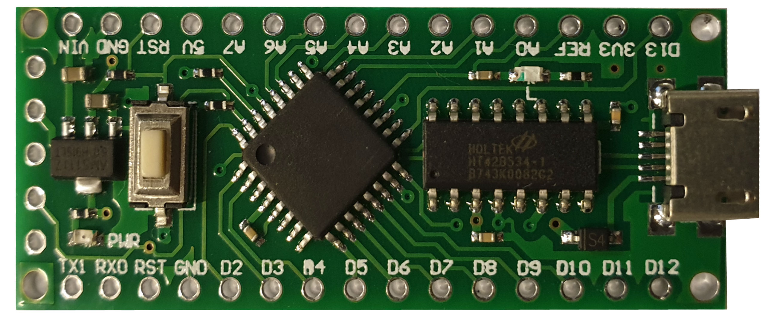

LGT8F328P LQFP32 SSOP20 BootLoader burning issues.
I came across several bootloader burning to LGT8F328P articles using:
  1. LarduinoISP which now supporting LGT8F328P.
  2. David Buezas LGT8FX optiboot_lgt8f328ps20.hex and optiboot_lgt8f328p.hex
  3. ArduinoISP reference page.
The circuit is setup like this image: LarduinoISP circuit.
  1. I have uploaded LarduinoISP sketch successfully to Arduino Nano ( Programmer ), with LGT8F328-SSOP20 as Target.
  2. However, when Arduino IDE's "Burn Bootloader" is clicked with "AVR ISP" as programmer, error messages shown as below:

  1. Which programmer suppose to use "stk500v1" or "arduino" under the "-c" parameter of avrdude.exe as the Arduino Nano is as Programmer with LarduinoISP sketch running in this case ?
Please help if anyone successfully burn BOOTLOADER into LGT8F328P chip.
Thank you.

I used the LarduinoISP.ino sketch and schematic from this page.
hi hmeijdam,
I followed the LarduinoISP diagram from your old post mentioned but I still cannot get it working.
  1. Before you click the "Burn Bootloader" from Arduino IDE, do you plug in the 10uF capacitor to short-circuit both RES and GND pins of Arduino Nano ( Programmer ) in this case ?
  2. There are two sides with RES and GND ( on Arduino Nano ), do you short-circuit both sides with two 10uF capacitors ?
  3. Can you check my LarduinoISP circuit setup HERE to see if there any mistake ?
  4. Do you still have your LarduinoISP physical setup circuit photo captured ? I there is, will it be ok to share here for reference ?
  5. Which CS or SS pin of LGT8F328P you are connecting to, pin 10 or 4 ?
Please advise.
I suspect something has changed since I last uploaded sketches to it. I now own an SWDICE MKII programmer, so do not use the LarduinoISP solution anymore.
For now the only way I can burn the bootloader is by installing the LGT8FX package from David Buezas
He mentions that you need another LGT328 board to make it a programmer, which I can confirm.
When I try to turn an Atmega328 based NANO into the ISP programmer I can't get it to work. I tried different versions of the LarduinoISP sketch. [EDIT] It works if you change the serial RX buffer from 64 to 250
When I swap the Atmega328 NANO for below green LGT328p NANO clone It works flawless.
I don't even need the capacitor nor the 10K pullup resistor and can burn sketches to it (overwriting the bootloader) and I can use "Burn Bootloader".

I looked better at the decriptions that David Buezas offered ant the difference is that when you select the Arduino Nano in your boards manager the hardware serial read buffer is 64
That buffer needs to be 250.
So I changed
#define SERIAL_RX_BUFFER_SIZE 64
into
#define SERIAL_RX_BUFFER_SIZE 250   // for LarduinoISP to work
in "HardwareSerial.h"
in directory E:\Arduino\arduino-1.8.13\hardware\arduino\avr\cores\arduino
(I have portable installations of many different Arduino IDE's, so it may be in a different folder on your PC)
Then I compile/upload the LarduinoISP sketch for the Arduino Nano (or UNO) and can use it as ISP for the LGT board.
Finally I undo my modification of the buffer size increase (as it increases the size of the compiled binary).
