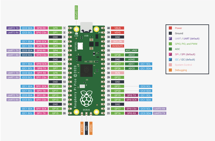

I've been trying to use ESP_AT_WM_LITE with a RPI Pico and an ESP-8266_01 for several days now, but unfortunately without success so far. I'm wondering where I should ask for help: on this thread or on Github maybe ? Or should I just create a new thread ?
In case it's OK to post here, here's a short description of the problem. Else, I'm happy to create a new issue on Github with the full details and output of the serial monitor.
Right now, I have no idea wether the problem is the hardware, the pins configuration in Mbed Core or the ESP or the library. Sorry, for asking here if the library is unlikely to be the problem...
To put it briefly:
  • I managed to flash an ESP-8266-01 with an AT firmware 1.7.4 (SDK 3.0.4)
  • The ESP is connected to the serial 2 (Tx on RX, and Rx on TX) of a Raspberry Pi Pico. I adjusted the pins in pins_arduino.h
  • The ESP responds to AT and AT+GMR in the Arduino IDE monitor when connected only with its USB adapter
But when I load the RP2040 example of the library to the Pico, the response in the monitor is always.
[ESP_AT] Cannot initialize ESP module
[ESP_AT] NoESP

Hi @nordseele
Thanks for using the library.
You have to connect ESP8266-01 to Serial port as follows:
ESP8266-01 <-> MBED RP2040
ESP8266-01 TX <-> UART0_RX = GP1
ESP8266-01 RX <-> UART0_TX = GP0
If you still have some issue, please post on ESP_AT_WM_Lite issue

Thank you very much for your reply.
I'm using the second serial ports (gpio 8 and 9) of the Pico on a custom PCB. I've modified pins_arduino.h in consequence but that's very likely the problem. I will disconnect the ESP from its header and connect it to the GPIO 0 & 1 for a test as mentioned in your post, hopefully this will work.
Thanks again :-))
Edit: After checking the schematics again, the TX and RX have been inverted by mistake on the PCB, probably because of a wrong pinout image of the ESP found on the internet... Serial2 works thanks to the workaround found on the other thread, I've been able to test that with a passthrough script but with the TX of the Pico going to the TX of the ESP of course the ESP won't work... I'm not sure if there's a way to invert the serial pins. Too bad...
No issue at all with your library. Just tested with inverted Rx and TX using Dupont wires and the library is working really great. Just my own mistake.
Also check this topic Serial2 on Raspberry Pi Pico to know why it didn't work with your connection.
