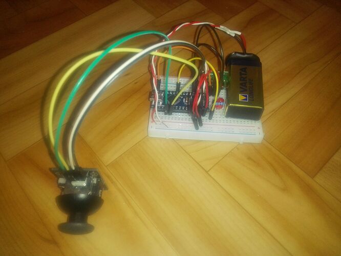

At the moment I am trying to build a remote controlled Lego Car. I use an Arduino Uno with the Adafruit Motor Shield v.1 and an Arduino Nano with a two-achsis-joystick as a remote. The Y-achsis of the Joystick should steer the car and the other achsis should control the motor speed.
I included the ServoTimer2 library, because the Servo.h and the VirtualWire library are not working together very well.
The transfer from the remote is working (serial monitor is giving the right feedback), but if I attach the servomotor, the DC-Motor will not run. Without the code “servo1.attach(ServoPin)” the Lego-motor can be controlled with the joystick.
At first I did not use the 433MHz RF transmitter/receiver an attached the joystick directly to the Uno board. With the Servo.h and the AFMotor.h library this combination worked and I could steer the car AND control the speed of the other motor.
I think it is a code/library problem, so I posted it in this section. There is no schematic diagram, I hope, the pictures will help.
The code for the car/receiver is from different sources and as you can see I am not an expert. I did not include the code of the transmitter, because the transfer is working. Perhaps someone can analyse the problem and find the error.

What is the default transmit pin? You can't ignore that, if you want that pin for something else.
Thank you very much for your reply!
The data line of the receiver module goes to the digital pin 14 of the Arduino in my setting. So far as i know, there is no default transmit pin and I think, that the pin 14 only is used for the transfer of the message between the remote and the receiving part.
The serial monitor is printing the right values (Serial.println(x_position); and (Serial.print ("Servo= ");Serial.println (x_position); ), so the transfer is working, but the servo is not moving.
Am I right, that you meant, that there is some sort of pin conflict or dual use of pins?
Digital pin 9 of the Arduino Uno is responsible for the Servo #1 control on the Adafruit motor shield, so there should be no interference between the transmit pin and the servo pin.
You'd be wrong, then.
The VirtualWire class is meant to be used on both the sending end and the receiving end. It has default values, and methods to change them, for both the transmit pin and the receive pin.
Ah okay, thanks again. The default receive pin is indeed pin 11. But you can configure the pin with the "vw_set_rx_pin(receive_pin)" function, what I did. And the default pin has still an influence on the setting?
The Adafruit Motor Shield uses pin 11 only, if the DC Motor #1 is used. That's not the case in my wiring.
I am still a little bit confused, because the transfer is working and if i did not attach the servo, the DC Motor is running and can be controlled by the remote.
Could you explain to me the connection between the VirtualWire class and the servo? What do I have to change to steer the car with the transferred data from the joystick? Or is the combination of the different components and libraries just simply not working?
