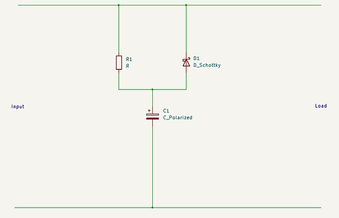

Put a diode between the capacitor positive and the positive supply so the diode points away from the capacitor. The capacitor can discharge through the diode but not charge. Put a resistor across the diode to charge the capacitor. To a good approximation the charge time of the capacitor is 5RC seconds, so use that as the basis for choosing the resistor value. Use a Schottky diode.

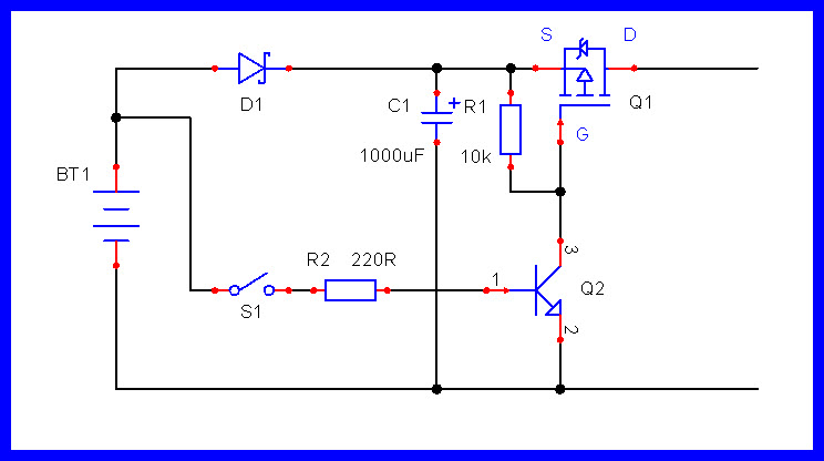

But as the turned on GSM module is operating it needs continous supply from the battery (through SWITCHED_VBAT on the schematic). The series resistor would limit the current and would reduce the efficiency with its voltage drop.
  • Why Q7 ?
This doesn't make sense for 2 reasons:
  1. My understanding is you have a brief drop immediately after turning on the GSM module, the capacitor is to cover that dip. If it's not a dip but a continuous problem then your power supply isn't capable of enough current.
  2. The resistor isn't in series with the GSM module, only the capacitor, to limit its charging, which I thought is what you asked for.

To prevent powering the GSM module though the 1k resistor when it is not needed.

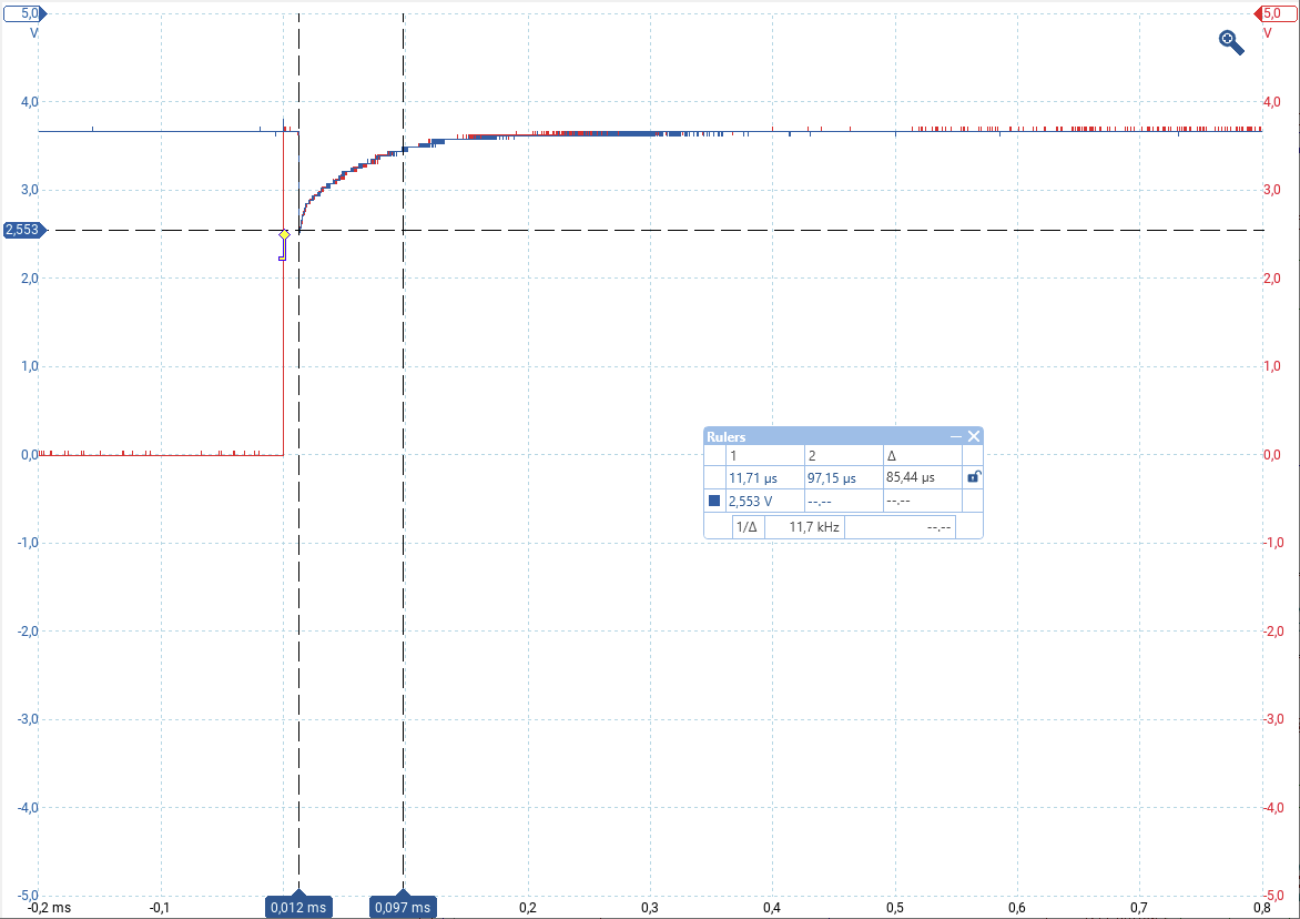

It's just a drop, like this:
Red signal rising edge is the switch on trigger for the MOSFET, blue is the measured voltage of the 33uC capacitor for the uC.
Then I misunderstood your answer. Can you provide a little sketch?

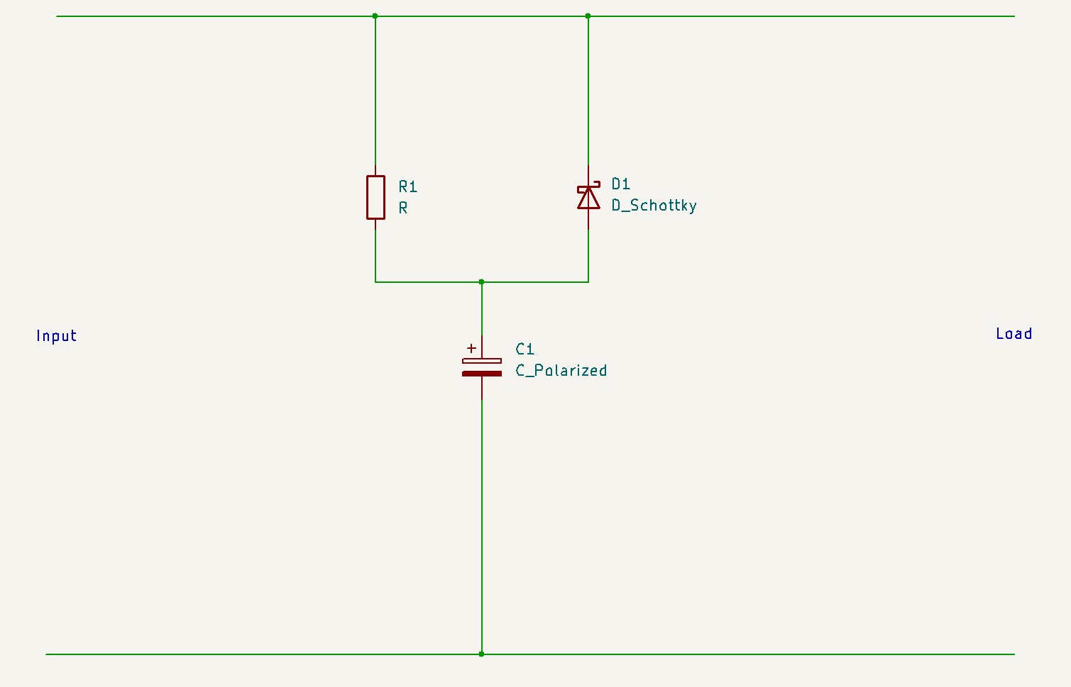

I hope this makes sense:
Charge current is limited by R1, discharge is through D1, with a small contribution through R1, especially for the first 0.2V, which is the drop across the diode. Note that I chose a Schottky diode for its low voltage drop.
If I read your oscillosscope trace correctly you are only trying to cover 85μs, so I doubt you need anything like 2000μF.
I've seen an issue with this or similar module, where it would send itself into a loop due to the voltage drop it create during power up. And I think you're right to use a capacitor, but you can probably (to be tried out) get away with a much smaller one, like 20-40% of the F you have now, and to remove Q6 and R31. Also make sure you have enough trace-width from the battery to the module.
