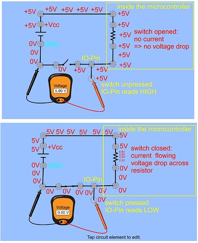

And this means: If you configure an IO-pin as input this input is so sensitive that even a 2 inches short wire will act as an antenna that catches up electromagnetic noise that is always present and make the IO-pin switch its state randomly between LOW and hIGH.
Depending on the amout of electromagnetic noise this could be once every few minutes or 50 times per second.
A pulldown or pullup-resistor reduces this sensitivity and enables reliable acting of the IO-pin. Using the microcontroller internal pullup-resistor has the advantage of no extra resistor required because you use the internal resistor build into the microcontroller.
Using a pullup-resistor inverts the logic levels of the IO-pin.
Pullup means
  • if switch is opened the IO-pin is pulled to +Vcc and sees a HIGH
  • if switch is closed the IO-pin is pulled to GND and sees a LOW
The picture shows what happends on the IO-pin if the IO-pin is configured as
pinMode(mySwitch, INPUT_PULLUP);
To make a code easier to understand you can use as many variables and constants as you want.
Here I recommend to use constants that say directly the state of the switch
as mentioned above
const byte open = HIGH;
const byte closed = LOW;
with these constants you can write if-conditions that directly describe what is happening
if (digitalRead(myLimitSwitch) == closed) {
  Serial.print("limit-switch found!");
if (digitalRead(myLimitSwitch) == open) {
  Serial.print("run motor");
self-explaining names.

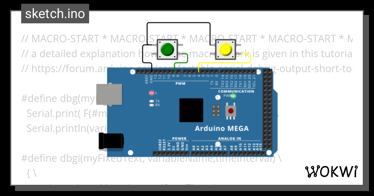

Below is a testcode to test your wiring.
This code uses debug-macros that work in this way
"dbgc" dbg as short for debug "c" short for change
This means only in case the value of the used variable / function had REALLY changed a message gets printed to the serial monitor

  pinMode(sensor0degL, INPUT_PULLUP);
  pinMode(sensor0degR, INPUT_PULLUP);
  BlinkHeartBeatLED(OnBoard_LED,250);
  dbgc("01",digitalRead(sensor0degL) );
  dbgc("02",digitalRead(sensor0degR) );

WOKWI-Simulation
You don't have to do it one after the other - you can do it in parallel. But not with multiStepper functions. Multistepper is meant for a coordinated move of two steppers to reach a target at the same time. But that's the opposite what is needed with homing. Homing is very individual for each stepper.
Not really. Your driver creates microsteps, and every motors.run(); call only creates one (micro)step at most during one do-while cycle. But you set the target ahead for 8 microsteps every cycle. That does not make sense.
But as already mentioned, you should not use multiStepper calls for homing anyway. ( But the misunderstanding with microsteps is the same when using AccelStepper calls )
basically what your code is doing is:
 do {
    increase the value of variables
    positions[0] by 8
    positions[1] by 8
    // this increasing is done REGARDLESS of
    // if a SINGLE step has been really executed
    // such a while-loop repeats 10000 times per second
    // this means before your stepper-motor has done
    // only a SINGLE microstep
    // variable positions[0] and variable positions[1]
    // has counted uo to value 1000
    // after a few microsteps has counted up to 3000
    // increasing, increasing, increasing very very fast
    // so what is happening is that you tell multistepper to rotate to
    // step no 1000, 3000, 5000, 7000, 9000, 11000 .......
    motors.moveTo(positions);
    motors.run();
    } while (homedR == 0 || homedL == 0);
// referenceing works this way
// do a SINGLE step or if you like to 8 microsteps
// check limit-switch
// if limit-switch changed to "pressed" stop
// if limit-switch has not changed to "pressed" do another single-step
// but not with increasing a target-position
// simply be DIRECTLY creating a
// SINGLE-step-pulse
