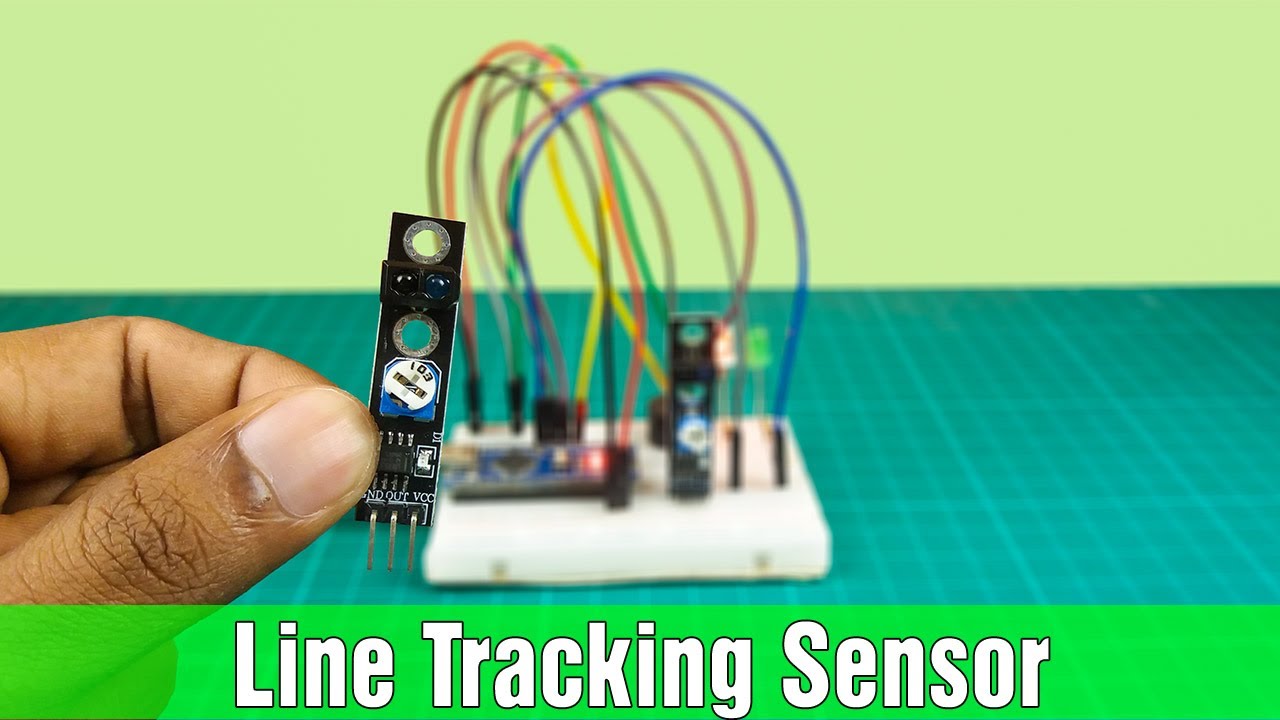

I'm working with a line follower, and I've got trouble.
the wheels don't rotate and the sensors ( KY-033 3 pins) detect everything, not the black line.
(my sensors are placed 3cm away from the floor)
Here is the video I saw to make the line follower :point_down:
Line Follower Robot using Arduino
I used these sensors:
but in the video, the guy uses these:

The sensor on your image, TCRT5000 has range 0.2mm - 15mm and peak 2.5mm.
30mm is definitely too much.
