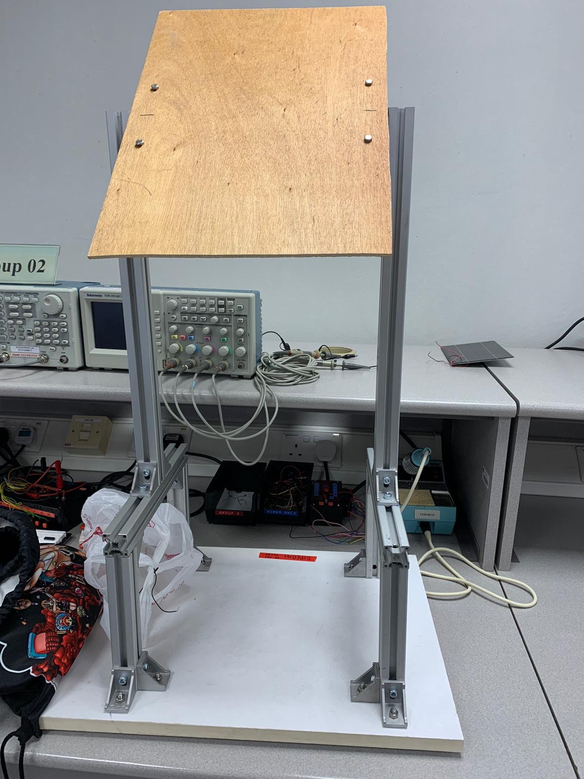

I am making a Solar Tracking System.
Basically what i have now is
- A Linear Actuator 12V DC
- 2 LDRs
- 1 Arduino Uno
- 1 H-Bridge L298N
I would like to control my Linear Actuator to move according to the light exposed to the 2 LDRs. I really have no idea how to continue.
I plan to have my starting position at the half way mark of the Linear Actuator and it will move according to the sunlight.
If east have more light, it will shift up.
If west have more light, it will shift downwards.
