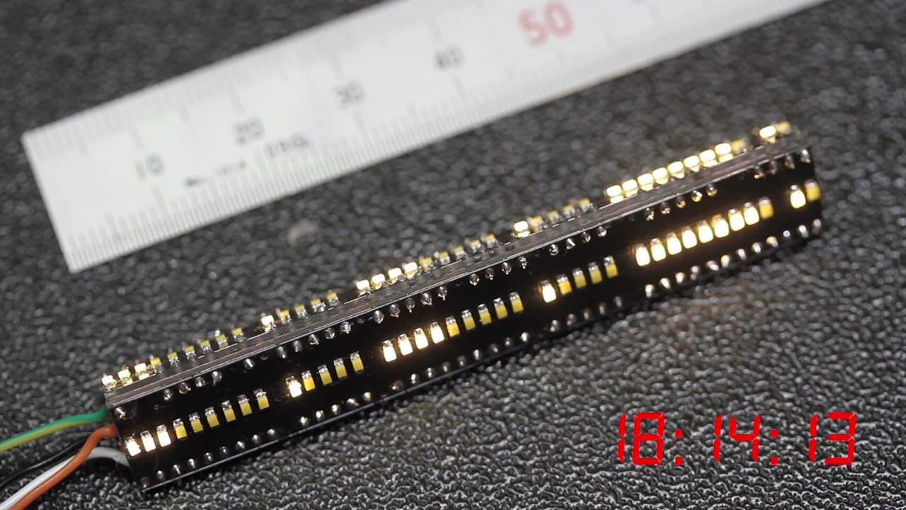

Thank you all for so many solutions you have suggested.
This one seems to be a convincing solution, even if I don't understand the formula at all. I'll have to look into it more closely.
I will also try to implement the built-in RTC with the hourly adjustment.
Now that the sketch is running, it was time to adjust the layout of the board. I've added a WS2811 so that none of them have an overarching function (seconds to minutes or minutes to hours). But that also means that one blue channel remains unused in each area.
Next step will be to order the pcb and look how it works.
I changed that from 1 hour (default) to ~10-hourly NTP updates.

Hi David,
thank you for your attempt. I just tried it out: the clock also runs perfectly with your solution. Disconnecting the power and reconnecting it also works without any problems.

Hello everyone,
I have finally made my way through all of your posts and also worked through the linked websites. I have now summarized the most suitable approaches in a sketch that combines all the good ideas. The time is now retrieved from the NTP server every hour.
I assume that the clock will be way too bright at full brightness.
The HEX value for half brightness is #7F7F7F.
Replacing 0xFF with 0x7F in the last line will halve the brightness.
In principle, any HEX value can be used here. For the sake of simplicity, the ten values ​​0F to 9F and the six values ​​AF to FF are suitable. This corresponds to a gradation of 6.25% (1/16) per brightness level.
By using these two symbols, the brightness of the entire clock can be dimmed in 255 levels (nobody will set level 0). The HEX value can be converted from the RGB values ​​1-255 on the following website: https://www.rgbtohex.net/
Thank you all for the time you sacrificed and the valuable tips
Here is the final sketch:

@kolaha , @david_2018 , @PaulRB
Hello,
as a small thank you for your active support, I would like to present you the final result (without the disguise yet). I would never have managed this without your help!
Michael
