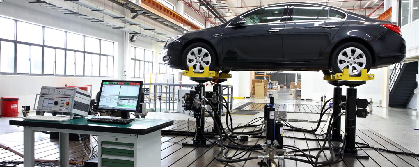

Basically I want to make a scale model o a Four Poster Test Rig which is basically a vehicle test using 4 actuators attached to the four wheels.
image below for reference
for this project I have four robotzone 4-2 linear servos, since is just a scale model i dont want to receive feedback from the servos or make them move with specifics loads, i just plan to make them move by random pulsations at a an amplitude of 4 inches probably.

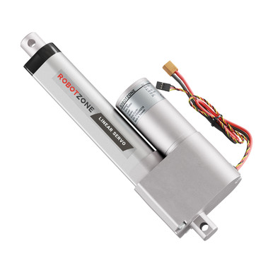

Its this servo
Yes I will be using a 12V 30A external power supply, I was planning to make the 4 servos do random movements by using a on/off switch which i think it relies more on the code but i feared i might need to buy a servo control module, something like a PCA9685
For more context this are the servos I’m using:
Spendy times four! Nice stuff.
You good:
The linear servo is designed to simply plug into a servo controller and run without any additional tuning or wiring from the end-user.

You would send "random" servo commands to position the actuators at different extensions between fully retracted and fully extended (4" stroke). The program must take into account the time that the linear servo actuator needs to make a commanded move, and delay accordingly between commanded moves.
writeMicroseconds()
Writes a value in microseconds (us) to the servo, controlling the shaft accordingly. On a standard servo, this will set the angle of the shaft. On standard servos a parameter value of 1000 is fully counter-clockwise, 2000 is fully clockwise, and 1500 is in the middle.
The timing of the linear servo PWM pulse, corresponding to given extensions, is stated on the product page:
PWM Signal (Fully Retracted) 	1900µs
PWM Signal (Fully Extended) 	1100µs
When you attach the servo object, you can put in the optional minimum and maximum pulse width arguments
  myServo.attach(thePin, 1100, 1900);
and then xx (0 <= xx <= 180) degrees in a call like
  myServo.write(xx);
will be full range motion.

I can't tell if you are brewing agreeing or disagreeing. From the product page for the " Heavy-Duty Linear Servo" @jooffles linked to:
While a linear servo may appear similar to a linear actuator, it functions quite differently. A linear servo responds to a PWM signal - to achieve the same results, a linear actuator would require a motor controller with a feedback loop capable of responding to a PWM signal. The linear servo is designed to simply plug into a servo controller and run without any additional tuning or wiring from the end-user.
a7
It is a "real servo", and performs exactly as expected for a standard hobby servo, except that instead of shaft rotation, it does shaft extension.
Similar devices have been on the market for many years, at much lower cost than this particular heavy duty model.
