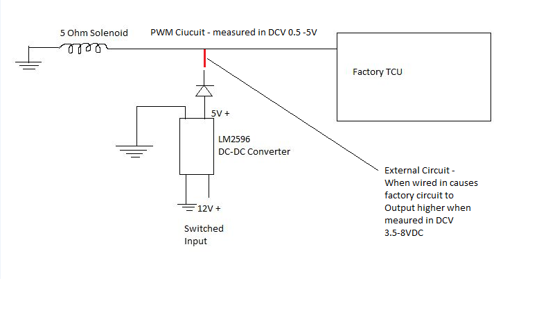

I have a circuit that starts at 3.5V and progressively increases to 8V
I'd like it to start at 0.5 and increase to 5Vso essentially I'd like to wash 3V off the circuit .

Sorry but yes you are 100% correct. The solenoid is controlled by a PWM signal after looking further into it.
I have measured the resistance through the solenoid and it is 5 ohms.

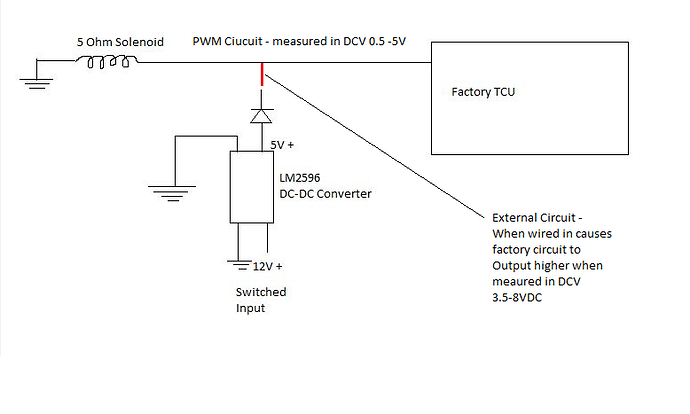

Attached is a crude drawing of the circuit again.
Sorry for the frustration this has caused. I really appreciate the assistance.
It is in fact a PWM switched circuit. When I remove the external input I added it operates as normal. But when I wire in the external supply and the TCU operates as it usually would the measure voltage in the circuit is 3VDC higher than it usually is and the operation of the system is much harsher which makes sense as it is not quite so gently modulated.
Assuming the TCU PWM circuit applies a high voltage or an open voltage the following will occur. When the TCU switches from high to open the ungrounded end of the solenoid will be driven in the negative direction due to the inductance of the solenoid. I am guessing that the high and low switching voltage that occurs at the solenoid terminal is charging the output capacitor or your PWM circuit through it's switching inductor and switching diode. The end result is a positive voltage getting generated on the output capacitor of your PWM circuit which causes the average voltage of the solenoid to increase when your circuit is connected.
I think your best bet would be to replace the diode that is in series with the PWM circuit with a relay. A P- Channel MOSFET would not work because of the reverse diode that is part of the MOSFET. Without knowing more details of the TCU circuit and the solenoid adding any circuitry to the solenoid pin risks affecting how the circuit functions.
You could test my theory by measuring the voltage on the switching regulator output capacitor when the TCU is commanding the solenoid on.
A changeover relay. You need to disconnect the TCU when you connect your control signal. There is a chance that the TCU will detect the open circuit though and flag a fault. Switching in a dummy load might be necessary to keep the TCU operating properly while you are overriding it.

I replaced the diode with a relay and this is what has occurred:
For the TCU to normally operate the solenoid the following conditions must be met:
  • Road Speed - 75km/h - 150km/h
    -Trans in gear
    -Foot off brake
    -TPS (throttle position sensor) between 10-70%
The TCU controls the solenoid under factory demanded conditions which is great.
When I switch my input and the factory system has not met its demanded conditions the system works fine.
However if I switch my input and and the TCU also has all conditions met and activates the solenoid the "combined" voltage is back up 8VDC again.
I also went a step further and when I switched my manual input in, I used a replay to switch out the Input from the TCU. The problem then is that the TCU creates a fault to Open circuit as it is looking for a 5-9 ohm resistance solenoid to activate.
On another track, is there a way to replicate the "solenoid" I also attempted to connect a 5ohm 10 watt resistor the the switched TCU circuit but it got far too hot. I added 6 more parallel resistors equaling 60 watts and still at 5 ohms but they drew 1.5 Amps and got hot still.
I think as its a PWM circuit a resistor will not be the best solution.

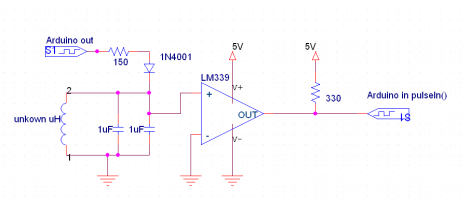

Did you try Googling :
"measuring INDUCTANCE with ARDUINO" ?
Measuring INDUCTANCE with ARDUINO
