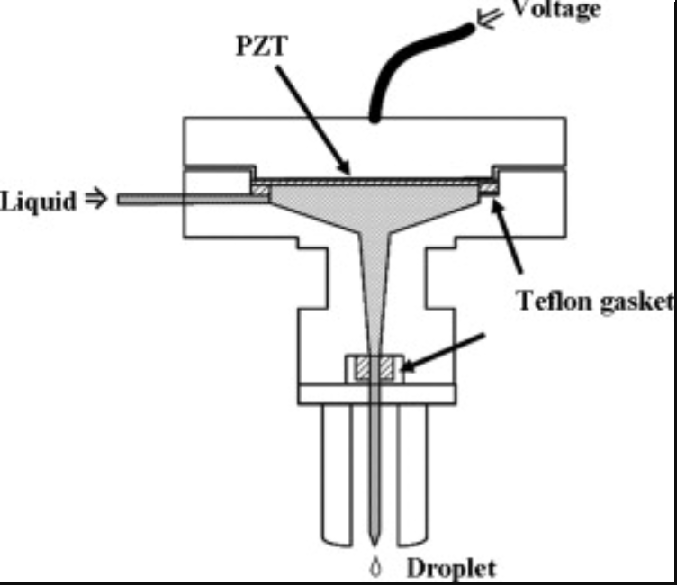

I just found this, not electrical solution, but very interesting.

One thing to be careful of is what ever you have in the container will or will not wet the surface and many NEVER form a drop.
