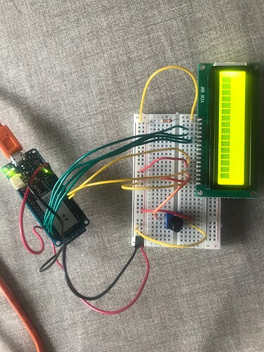

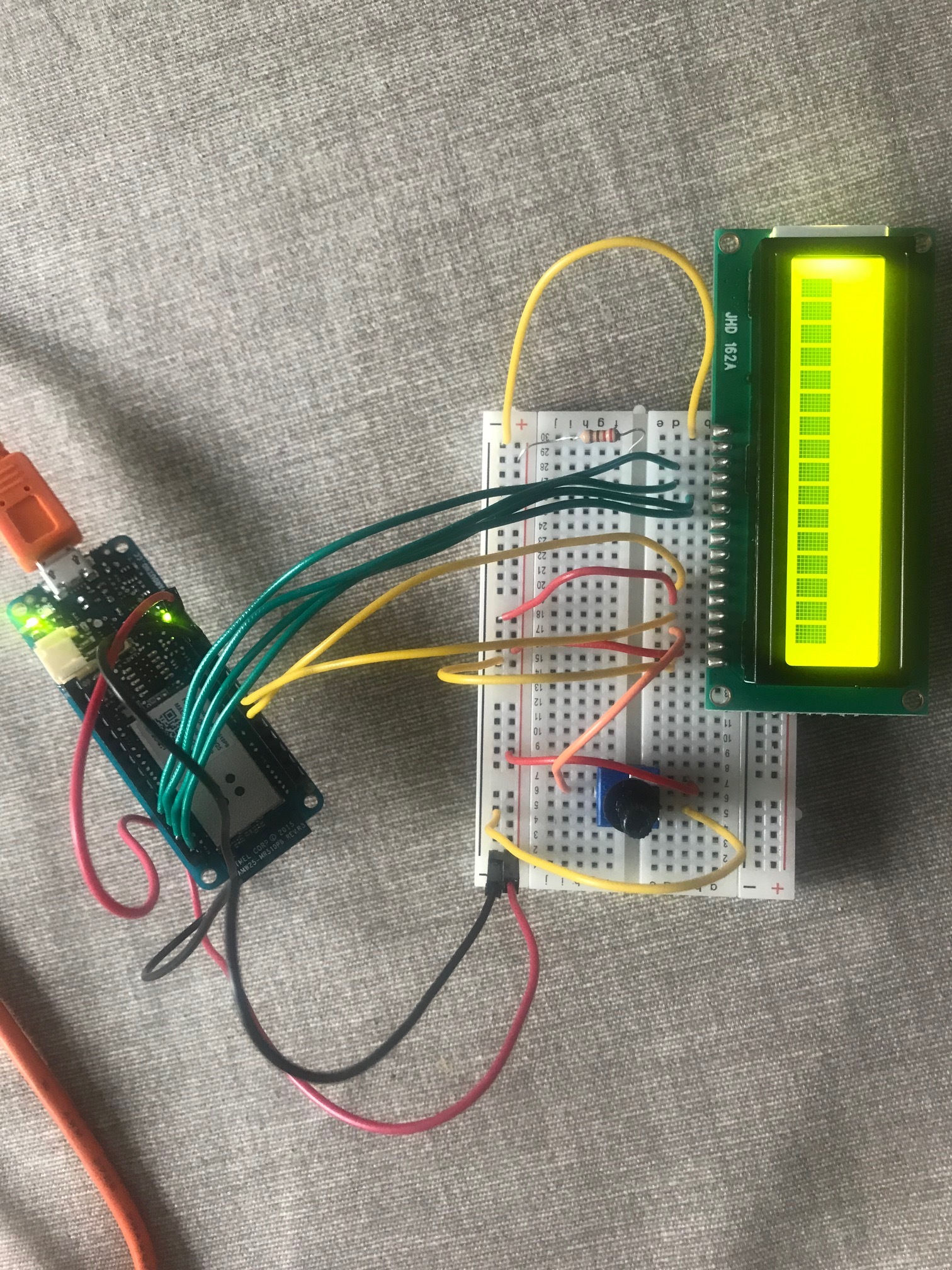

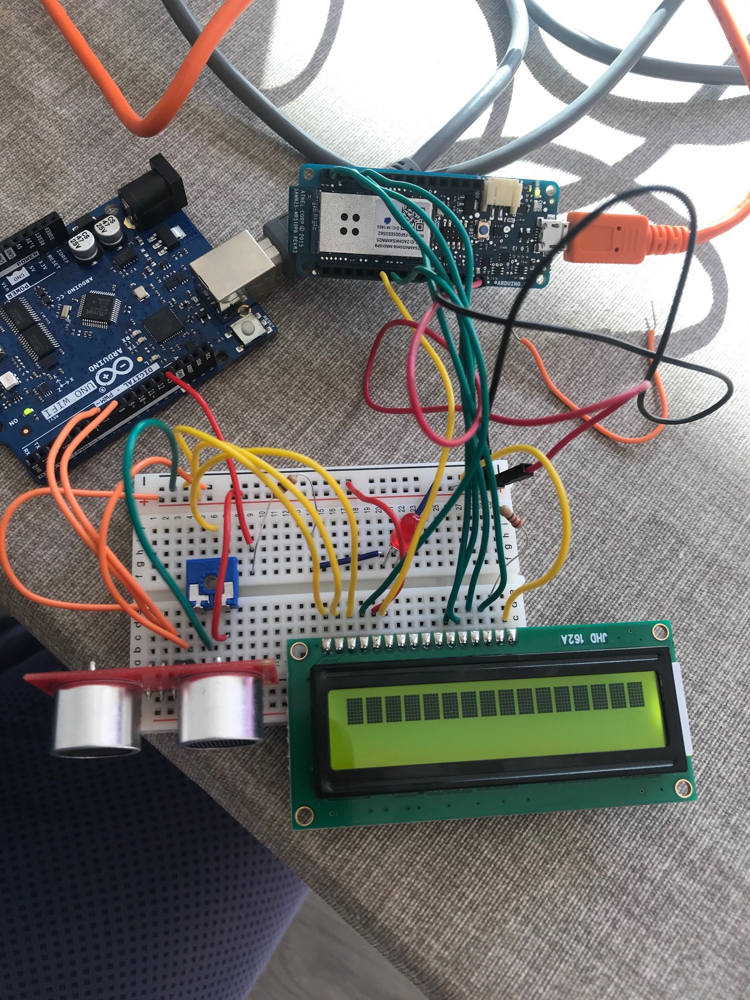

Ok, I managed to upload the sketch to the arduino this time with the HD44780 library. Now the screen is showing only black boxes. I tried a different demo sketch and also switched from the UNO Wifi Rev2 to an MKR1000 board but always with the same result. This internet is telling me to look for wiring issues but I can't find any.
Everyone will tell you it's impossible to diagnose wiring issues by looking at a rats-nest of wires in a photo. Sorry.
But you have two boards and all kinds of unnecessary components there.
If something isn't working, start with the bare minimum of components necessary to test the non-functional component - For me that would be the LCD and ONE Arduino.
The UNO WiFi doesn't seem to have a ground connection to the breadboard?
Also, there seems to be no ground connection to the Arduino here:

Have you tried adjusting the contrast on the display? I'm not near a computer where I can look up the proper wiring.
I cleared up the mess :slight_smile:
The diagram I replicated can be found here: https://www.arduino.cc/en/Tutorial/LiquidCrystalDisplay
Adjusting the contrast does only dims the black squares unfortunately.
What Arduino board is that?
Please post the code that you tried.

It's the MKR1000, but the result is identical with the Uno Wifi Rev 2.

Did you adjust either the code or the wiring to the appropriate pins? Your original code used pins 2, 3, 4, 5, 11, and 12, the last code you posted uses pins 4, 5, 6, 7, 8, and 9. The wiring looks appropriate for the original code, not the code from the hd44780 library.

SOLVED! when switching from liquidcrystal.h to hd44780 I forgot to change the wiring. Thanks!
