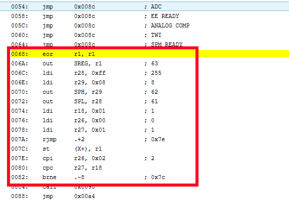

Location of startup prefix code?
When building a new (and empty) Uno project, the resulting executable always winds up with a bit of prefix code to clear SREG, set up the stack and initialize global variables prior to the jump to main():
Where is this code located in the Arduino IDE folder? More to the point, what's the easiest way to get rid of it?

Thanks for the response Budvar10, but the desire to "solve every tiny thing" is actually the whole point behind my question (I'm currently experimenting with AVR subset implementations on FPGA). The screenshot above is actually from an embedded debugger in an AVR simulator I wrote years ago, so I'm fairly confident with the hardware side of things. I'm just trying to find out if there's a quick and easy way to use the IDE for code generation, and that prefix code is currently getting in my way.

It strips the RAM initialization loop, but not the SREG and stack setup instructions.

The gcrt1.S is maybe what you are looking for.

That definitely looks like the right source file, now it's just a matter of figuring out where that is in the current Arduino package...v1.8.5 doesn't seem to have the same gcc folder structure that was present in earlier builds?
It's part of the compiler/libc package, so it's somewhere like .../hardware/tools/avr/avr/lib/avr5/crtatmega328p.o
Get rid of it by compiling and linking with avr-gcc from a CLI instead of the IDE, using the -nostartfiles switch. Note that this will get rid of your vectors as well; they're both part of the crt file.
For example, the optiboot bootloader suppresses these, and its compile line looks like:
avr-gcc -g -Wall -Os -fno-split-wide-types -mrelax -mmcu=atmega328p -DF_CPU=16000000L -Wl,--relax -nostartfiles -o optiboot_atmega328.elf optiboot.o
Yeah, looks like that's what I'll have to do. I tried adding -nostartfiles to the IDE options, and I even linked manually to make sure I wasn't including core, but it doesn't seem to have worked.
