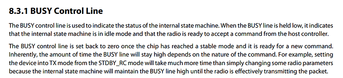

I took a look at the new RH SX126X library file, but could not see any mention of the SX126X BUSY pin being supported, so I am not sure how the library can work without it. There appears to be no published examples for the SX126X.

Or maybe does not even work, I could not see the definition or use of the SX126X BUSY pin.
Busy pin support for the SX126X is documented in RadioHead, version 1.129, and reportedly tested with Teensy 3.1.

Thanks, looks like the busy support was added at the end of March.
Could be useful.
