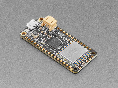

Useful figure, thanks! If you have looked at the Adafruit LoRa/MCU modules lately, they have built in Li battery chargers, complete with an enable input so that the entire module can be powered up and down with an autonomous power timer, if desired.
The receive current of an SX127X is in the region of 12-15mA, the SX126X uses DCDC conversion to power the low voltage RF stuff so the receive current is cut in half.
Which one in particular ?
I'm currently experimenting with this one:
Sorry, posted the wrong link. It is this one with the M0 processor
Nice board.
I do like the SAMD21.
I have used one with a SEEED XIAO SAMD21 to build a TTN\LoRaWAN node. The combination worked well. I especially liked the sleep which would allow you to pause a running program down to a 5uA current. So much easier to work with than the 'deep sleep' of the ESP32s etc.
Have you noticed that RadioHead already has a driver for these devices? I'm currently learning how to use the RHMesh examples, and it appears that to switch between the SX127X (RH_RF95) and SX126X devices, one need only load the appropriate driver.
