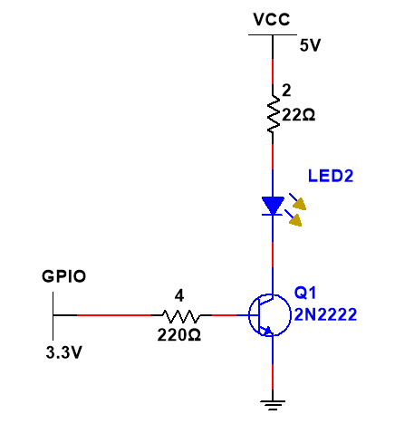

I use TSAL6100 led, my current diagram is like this, I just need the led to emit enough power to be able to control the air conditioner at a distance of 3m in the room, I will fix this ir control system on the wall opposite the air conditioner
At first I used a led that could withstand a current of 10-20mA, a voltage of 1.2V-1.5V, but it seemed to only work about 1.5m and had to be brought in immediately for air conditioning. So I plan to use TSAL6100 led, I need advice on the circuit to emit the best led, ensuring that the components and microprocessor are safe.

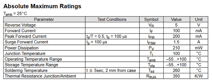

Here is the link to the data sheet.
It would have been helpful for you to have posted this.
Your transistor circuit should allow about (5V-1.35V-0.7V)/22 = 130mA current to flow through the led. The base current will be about (3.3V-0.7V)/220 = 11mA. These values seem ok and should give more than 1.5m range I think.
So the problem could be the base carrier frequency as mentioned by @jremington. If the wrong frequency is used, the receiver will be much less sensitive, even though the transmitter is sending a strong signal.
To know the correct carrier frequency for the receiver, you need to know it's model number. This may be shown on an internal schematic diagram for the air conditioner. Using the receiver model number, you can find it's carrier frequency from its data sheet.
If you cannot find that, it might be possible to test a range of commonly used carrier frequencies to see if any of those give more sensitivity and range.

I think your plan should be good. You could try this circuit with your existing led. Many IR LEDs have similar specs. If the circuit damages your existing led, you can go ahead with your plan to buy the TSAL6100.

I would assume that his Toshiba IR library has the correct carrier frequency. And if his code works, even at 1.5m, it's probably good. But I'm not clear whether he has actually tried the 22R resistor. If he got even a little distance with the original 220R, the new circuit really should work.
I was thinking the same thing, since he has 5V available. But then the resistor would be reduced to around 10R to keep the same current.

In that circuuit I would use two LEDs in series and a 18 Ohm resistor.
Assuming Vf of 1.6volt of the LEDs at that current, it would top a safe 0.1A.

I would expect successful 3m range with the circuit posted. Are you sure it's TS6100? Are you aware that the angle is quite narrow?
If you are careful not to give anything else than that short signal pulse to LED, you can go much lower with the LED series resistor.
And make sure that 5volt rail is properly buffered (with a 470uF+ capacitor).
