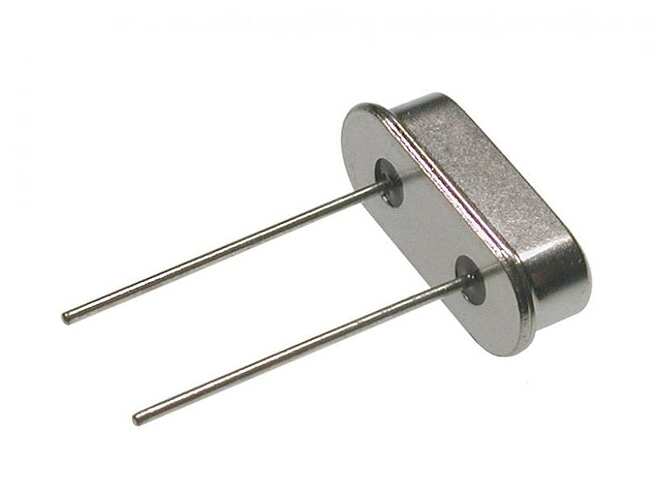

One of my automatic gates here on the farm had stopped working due to cold weather and frozen soil heaving. I am in the process of changing the gateposts and making some modifications to the overall gate installation. While I was working on some mechanical parts I dropped a screw driver on top of the control panel where the Arduino UNO is mounted. The handle of the screwdriver bounced off the edge of the electric panel box and landed on top of the Arduino board. It hit on a glancing blow and simply pushed one end of the tiny oscillator approx. 1/4". The pin on one end is sheared off and I suspect that the pin at the other end of the oscellator may be damaged. The attached photo is not the actual damaged UNO controller. I just wanted to show the oscillator.
I have carefully inspected the entire UNO board and it seems that this is the only damage.
Yes, I plan to replace the controller with a new one but I still want to repair the original.

Its a quartz crystal, not an oscillator, I believe - for the ATmega16U2 that talks to the
USB port. Any standard crystal of the right frequency is likely to work, check the ATmega16U2
datasheet for definitive requirements.
It is a 16MHz quartz crystal, which allows the atmega16u2 to run at that speed, you can see it on this schematic :
uno schematic
and in addition to LarryD's links, here is one more :
crystal
(from my own experience, very quick delivery)

Wow. Be glad you didn't whack the 16U2 or the resonator for the 328P.
You're probably OK... the board looks OK from what I can see in your picture. When you remove the old crystal and clean out the holes, be VERY careful not to overheat the traces or damage the plate-throughs. I've been working in electronics for over 40 years and I still need to tell myself to be extra careful with Arduino boards and their flimsy PC boards (and I've wrecked more that a few anyway).
Since that crystal only feeds the USB chip, the UNO should continue working fine without it. It's only uploading of new sketches or Serial.printing to the usb port that should be disabled.
If you were to remove the crystal from the board (by carefully heating the remaining leg and pulling) I think you should be able to bodge it for now. Soldering on a short patch lead to the stub (and remaining leg) should allow you to connect it back to the board.
