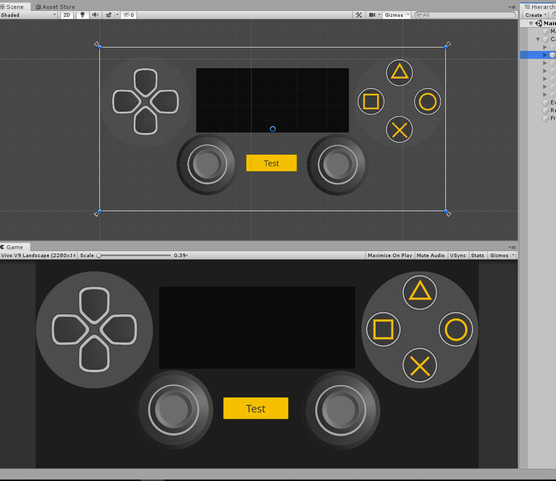

Hi, I had the same problem of not finding a suitable app to properly control a RC tank that I was making, so I decided to make my own using Unity and native plugins for android.
This is the interface my app will have, along with 2 joysticks that send numerical values whenever you move them.
The buttons send different values when they are pressed down and released, like for example you can assign a number like 500 for pushing the 'X' button down and 501 for releasing it.
I'm making it fully customizable and it will even include a terminal mode for sending/receiving text. The black region you see in the middle is actually a text logger, will display all values that are sent and received and errors if they happen, all in different colours. 8)
So far the app is working fine without any bugs, I just want to polish it and make it Play Store-worthy and then I'll release it.
