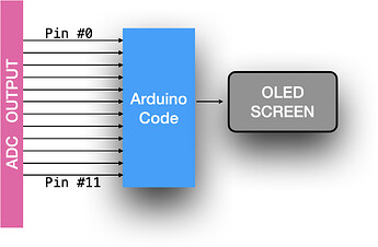

Looking for an Arduino board which would help in converting 12 bit binary input to decimal equivalent
brute force approach would be something like this
const byte adcPins[] = {2, 3, 4, 5, 6, 7, 8, 9, 10, 11, 12, 13}; // 12 pins for the 12 bits from LSb tto MSb

  • you list your 12 pins (from Least Significant bit to Most Significant bit) in an array
  • you configure those pins as input
  • you have a function that reads the pins status in order and if a pin is HIGH then you put a 1 in the corresponding bit of your sample value (if it's LOW we already have a 0 in that bit position since we initialized the value to 0)
side note: digitalRead() is not super fast. So it would be faster and more "in sync" if you were to use PORT register : choose pins carefully so that they are in the order of the PORT and with 2 quick registers reads you get the value of 8 bits of the PORT in one go. Mask what you don't need (the top 4 bits of the MSB) and then combine the LSB and masked MSB into your uint16_t

OP does not have 0xFFF, he has 12 pins which can be HIGH or LOW and wanted to build up 0b111111111111 (if all were HIGH) and print that value in decimal on a screen

Op is talking about the state of the 12 pins of his ADC

➜ That was an XY problem and OP started with a wrong description of his needs.
➜ if you read further down the thread, you'll see the real question is as follow:
so that's the ask:
and the answer is something like this
const byte adcPins[] = {2, 3, 4, 5, 6, 7, 8, 9, 10, 11, 12, 13}; // 12 pins for the 12 bits from LSb tto MSb, as INPUT
uint16_t adcRead() {
  uint16_t value = 0;
  for (byte i = 0; i < sizeof adcPins; i++)
    if (digitalRead(adcPins[i]) == HIGH) bitSet(value, i); // set the bit that needs to be 1
  return value;
the value you get from a call to this adcRead() function is what you just print() to the OLED screen. There is NO need for any change of representation.
