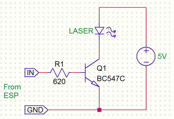

Yes, but an ESP32 doesn't have the 5v output that the laser needs. The pin will be driving a mosfet not the laser directly. As for encoding, the input is converted to ASCII then Binary and sent to the receiver by iterating through the binary array.
so take a MOSFET that you can drive at 3.3V. It's a no brainer.
but the laser needs 5v................
do you understand what transistors do?
The circuit with the mosfet provides the actual power to the laser, not the arduino.
The arduino is just the trigger.
Like this:
Oh, that makes more sense thanks. So an esp32d is a fine choice? or should I choose a different variant/board?
any arduino will do for the laser part - you just need to flip a pin HIGH or LOW.

Yes, but the OP has not identified HOW they handle a byte of x"00 or a byte of X"ff. Are they also clocking the transmitter and receiver as if it was a standard serial connection? Would be nice to see a schematic of the system. Are they just using the Arduino serial connection to somehow turn the laser on and off?
