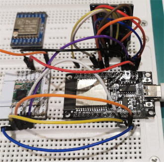

Lora + sd + esp32 chip
For the LoRa library, if your changing the SPI bus from default you would normally se this command, as detailed in the library API;
LoRa.setSPI(spi);
I have mixed LoRa devices and SD and TFT displays on the same SPI bus extensively, mainly on ESP32S3.
Whilst the combination works well with no crashes etc, I have noticed that the SD card can go offline under heavy use.
So my preferred setup is to leave the LoRa device and TFT display on the default SPI bus and put the SD card on the HSPI bus. This is more reliable.
Or use the SD card in MMC mode which eliminates the potential SPI conflict completely.
I also have not gone beyond version 2.0.14 of the ESP32 core for Arduino, too many issues with some well established libraries.
could you share me a code example that works for you? so I can adapt mine and tell you if it works
Having the SD on its own SPI could be helpful as some SD cards don't play nice on the bus. They don't tri-state MISO when they're unselected.
Not really, I dont use the same LoRa library your using.
I would suggest you just setup a basic code that has both the LoRa device and SD card run on the default SPI bus.
Check that such a basic code initializes both the LoRa device and SD card without crashing.
Do post a picture or link for the SD card module\holder, as @gfvalvo has said some such module\holders dont work properly.
try the following with SD card on VSPI and RFM95 on HSPI

serial monitor output
SD Card Type: SDSC
SD Card Size: 121MB
Listing directory: /
  DIR : System Volume Information
  FILE: data.txt  SIZE: 486
  FILE: test.txt  SIZE: 77824
  FILE: foo.txt  SIZE: 13
  FILE: TestNumber.txt  SIZE: 2
  FILE: test1.dat  SIZE: 7
  FILE: test2.dat  SIZE: 12
  FILE: test3.dat  SIZE: 68
  FILE: test5.dat  SIZE: 7
  FILE: test6.dat  SIZE: 7
  FILE: test7.dat  SIZE: 7
  FILE: test8.dat  SIZE: 7
  FILE: test9.dat  SIZE: 7
  FILE: test10.dat  SIZE: 14
  FILE: test11.dat  SIZE: 7
  FILE: test12.dat  SIZE: 7
  FILE: test13.dat  SIZE: 5
  FILE: test14.dat  SIZE: 354
  FILE: test15.dat  SIZE: 35
  FILE: test16.dat  SIZE: 10682
  FILE: test17.dat  SIZE: 259
  FILE: test18.dat  SIZE: 343
  FILE: test19.dat  SIZE: 42
  FILE: test20.dat  SIZE: 300
  FILE: test21.dat  SIZE: 55
Creating Dir: /mydir
Dir created
  DIR : mydir
Removing Dir: /mydir
Dir removed
Listing directory: System Volume Information
Failed to open directory
Writing file: /hello.txt
File written
Appending to file: /hello.txt
Message appended
Reading file: /hello.txt
Read from file: Hello World!
Deleting file: /foo.txt
File deleted
Renaming file /hello.txt to /foo.txt
File renamed
Reading file: /foo.txt
77824 bytes read for 188 ms
1048576 bytes written for 256 ms
Total space: 120MB
Used space: 0MB
ESP32 LoRa RFM95W Receiver
Starting LoRa OK!
Received packet 'hello 2282' with RSSI -51
Received packet 'hello 2283' with RSSI -50
Total space: 120MB

I finally solved it, it works now :slight_smile:

And the problem with your original code was ?
Initialization and instances were bad. Now everything works fine without any hitches
