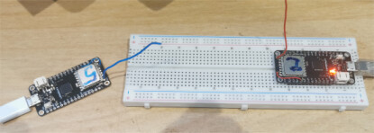

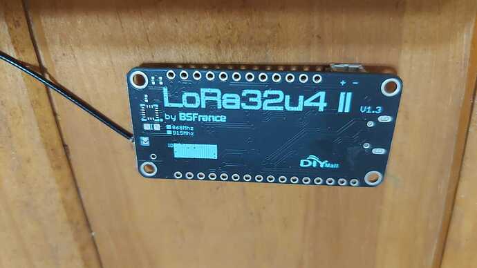

Here are images of my modules
A closer look

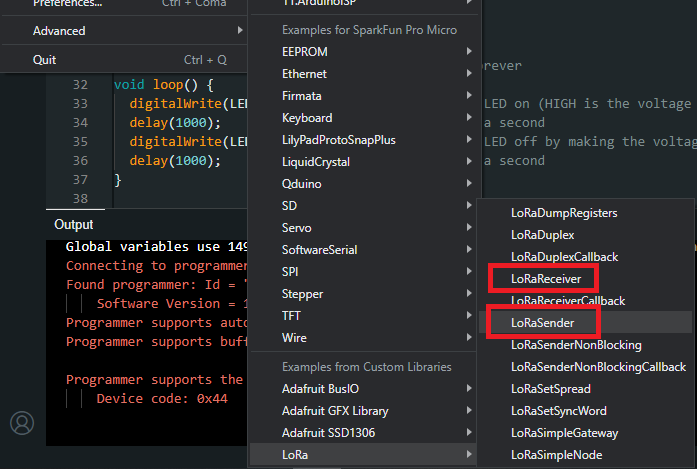

I tried to use the options you recommended as follows:

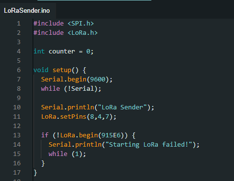

in the lora sender code y added LoRa.setPins(8,4,7);
For the transmitter I can see that it transmits (or at least I think it does)
In the reciever i used the Lora reciever code adding LoRa.setPins(8,4,7); too, but it doesnt recieve anything
both of them are powered by usb from a pc
where did you call setpins()
should be before the LoRa.begin() where you set the frequency
 LoRa.setPins(8,4,7);   // for Lora 32u4
  if (!LoRa.begin(866E6)) {
is before LoRa.begin
how close together are the modules? if too close the transmitter can overload the receiver
