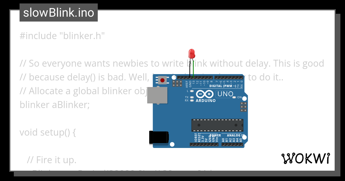

You'll have to do it in software. Even with the highest prescale and 16-bit timer you can only get about 0.25 Hz (4 seconds).
Here's a way of doing it.
-jim lee
