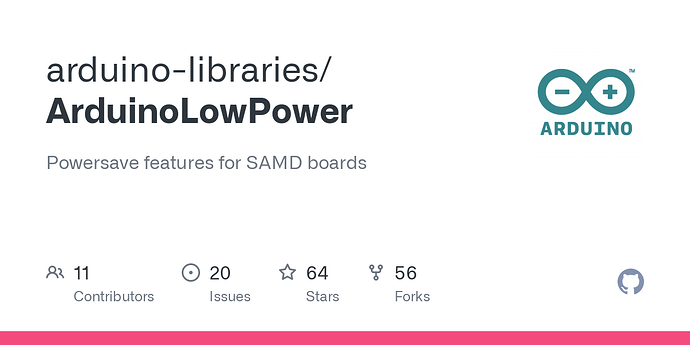

When your code requires a library that’s not included with the Arduino IDE please always post a link (using the chain link icon on the toolbar to make it clickable) to where you downloaded that library from or if you installed it using Library Manger(Sketch > Include Library > Manage Libraries) then say so and state the full name of the library.
ArduinoLowPower repository:
https://github.com/arduino-libraries/ArduinoLowPower
