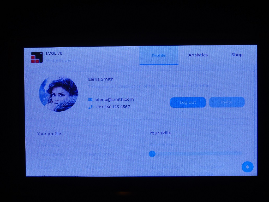

At this point i abandoned LVGL and doing my job with Arduino_GFX_Library
Looking forward to someone's experience with this platform
Selected board in Arduino IDE: ESP32S3 Dev Module, PSRAM: OPI PSRAM
https://github.com/moononournation/Arduino_GFX/tree/master/examples/PDQgraphicstest
with #define ESP32_8048S070 in Arduino_GFX_dev_device.h line 10:
https://github.com/moononournation/Arduino_GFX/blob/master/examples/LVGL/LvglHelloWorld/LvglHelloWorld.ino
with Arduino_GFX_dev_device.h copied to this example, and example modified to:
/* OPTION 1: Uncomment a dev device in Arduino_GFX_dev_device.h */
#include "Arduino_GFX_dev_device.h"
#ifndef GFX_DEV_DEVICE
/* More dev device declaration: https://github.com/moononournation/Arduino_GFX/wiki/Dev-Device-Declaration */
#if defined(DISPLAY_DEV_KIT)
Arduino_GFX *gfx = create_default_Arduino_GFX();
#else /* !defined(DISPLAY_DEV_KIT) */
/* More data bus class: https://github.com/moononournation/Arduino_GFX/wiki/Data-Bus-Class */
//Arduino_DataBus *bus = create_default_Arduino_DataBus();
//Arduino_DataBus *bus = new Arduino_HWSPI(0, SS); // ESP8266
//Arduino_DataBus *bus = new Arduino_HWSPI(17, SS); // ESP32
/* More display class: https://github.com/moononournation/Arduino_GFX/wiki/Display-Class */
//Arduino_GFX *gfx = new Arduino_ILI9341(bus, DF_GFX_RST, 0 /* rotation */, false /* IPS */);
//Arduino_GFX *gfx = new Arduino_ILI9486_18bit(bus, 2, 0, false); // ESP8266
//Arduino_GFX *gfx = new Arduino_ILI9486_18bit(bus, 16, 0, false); // ESP32
#endif /* !defined(DISPLAY_DEV_KIT) */
#endif /* !defined(GFX_DEV_DEVICE) */
and lv_conf.h configured as commented:
https://github.com/moononournation/Arduino_GFX/tree/master/examples/LVGL/LvglWidgets
with Arduino_GFX_dev_device.h copied to this example, and example modified, as above.
With touch.h configured/modified:
 #define TOUCH_MODULES_GT911
 #define TOUCH_MODULE_ADDR GT911_SLAVE_ADDRESS1
 #define TOUCH_SCL 20
 #define TOUCH_SDA 19
 #define TOUCH_RES 38
 #define TOUCH_INT -1
// Please fill below values from Arduino_GFX Example - TouchCalibration
bool touch_swap_xy = false;
int16_t touch_map_x1 = 0;
int16_t touch_map_x2 = 800;
int16_t touch_map_y1 = 0;
int16_t touch_map_y2 = 480;
and with lv_conf.h modified line 738:
/*Show some widget. It might be required to increase `LV_MEM_SIZE` */
#define LV_USE_DEMO_WIDGETS 1
LVGL works with Arduino_GFX on this display!
-jz-
Since then i managed to rule LVGL and this particular display. Even on VSCODE (which doesn't freeze and strangely "Offline" like ArduinoIDE).
Gonna post about findings if someone interested.
