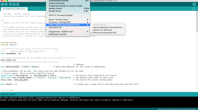

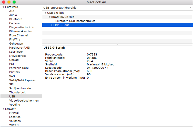

I've followed all the links you posted on that thread, I'm stuck on the 2nd step here: https://www.mac-usb-serial.com/wordpress/support/troubleshooting/ first I have to check if I have conflicting driver with a few commands in the terminal, it shows up I don't, then for step 2 it says I have to plug in my USB and do some other commands, well this part is impossible to do for me, because when I plug in my USB my macbook freezes immediately and crashes... that's the whole thing..
Pert after retrying multiple times, and deleting the old WCH drivers successfully it looks like it worked, but only once until the next restart. I did the whole process again and it looks like it works now man!
Thank you so much, I hope it keeps working, a question: it won't harm my macbook right or something?
Here are some screenshots (attached), the current is all fine, right? :smiley:
