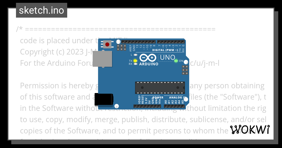

run this example to see the glyphs and associated bytes (calculated at run time)
you should see
Character: A 1 byte 0x41
Character: B 1 byte 0x42
Character: C 1 byte 0x43
Character: D 1 byte 0x44
Character: µ 2 bytes 0x0C2 0x0B5
Character: € 3 bytes 0x0E2 0x082 0x0AC
Character: à 2 bytes 0x0C3 0x0A0
Character: ü 2 bytes 0x0C3 0x0BC
Character: 你 3 bytes 0x0E4 0x0BD 0x0A0
Character: 好 3 bytes 0x0E5 0x0A5 0x0BD
Character: ( 1 byte 0x28
Character: n 1 byte 0x6E
Character: ǐ 2 bytes 0x0C7 0x090
Character: 1 byte 0x20
Character: h 1 byte 0x68
Character: ǎ 2 bytes 0x0C7 0x08E
Character: o 1 byte 0x6F
Character: ) 1 byte 0x29
Character: :grinning: 4 bytes 0x0F0 0x09F 0x098 0x080
The message [ABCDµ€àü你好(nǐ hǎo):grinning:] has 33 bytes and 19 glyphs.

const char * message = "ABCDµ€àü你好(nǐ hǎo)😀";
