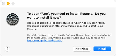

Hi @gamma69. Although Arduino IDE 2.x is a native Apple Silicon application, it uses various helper tools and some of these tools are only available in "Intel" (x86) builds.
Apple has created a "binary translator" named Rosetta 2 that allows x86 applications to run on Apple Silicon machines. So the problem can be solved by simply installing Rosetta 2. You can do that by following these instructions:
That's strange, I never installed Rosetta 2, but I am a newer M3 Mac, so maybe pre-installed?
You probably just forgot that you installed it. When you attempt to open any "Intel" (x86) app, macOS will automatically offer to install it for you:
I'm sure you saw that dialog at one point, clicked "Install", then never thought about it again.
But macOS isn't smart enough to do that when the Apple Silicon build of Arduino IDE attempts to invoke an x86 tool dependency so you only get this more cryptic "bad CPU type in executable" error.
