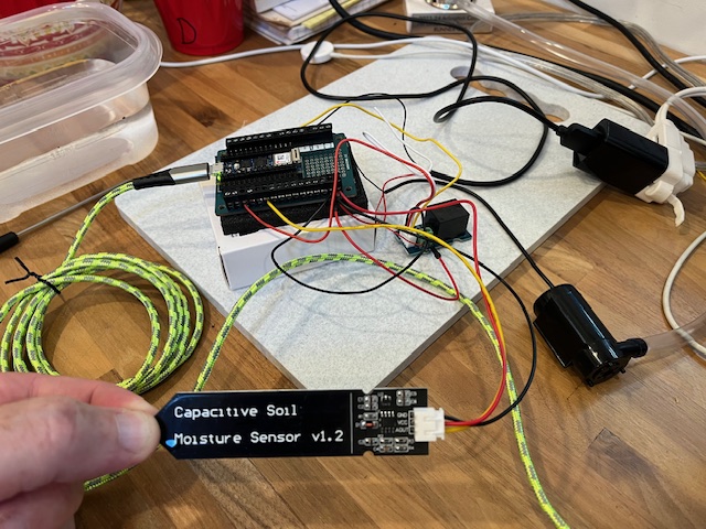

Sensor is at bottom of photo. Arduino Nano Connect in a Screw Terminal adapter in center. Relay and small pump to the right and USB for 5v power at top right.

It's hard to see exactly from your picture, here's a cropped pic of both your sensor and the one from Amazon
Maybe I'm fooled by the light and the blurry pic.
What text can you read from the two IC's U2 and U1?
U2 says 662K. U1 says NE555, then next line is TI logo 21K, and bottom lime says XBL8 G4
the 662k is a 3.3 voltage regulator and a NE555 needs minimum 4.5 Vcc. Something's fishy. Did you have a multimeter? Measure voltage between GND (left bottom) and Vout (right bottom)
I just rewatched the video you submitted. I have the right voltage regulator U1, 662K. I have the older timing chip U2, NE555, but I'm supplying 5.0V so it should be good.
With the probe in water, Aout reads 0.82V With the probe dry, Aout reads 2.19V.
Sorry - voltage regulator U2, 662K
